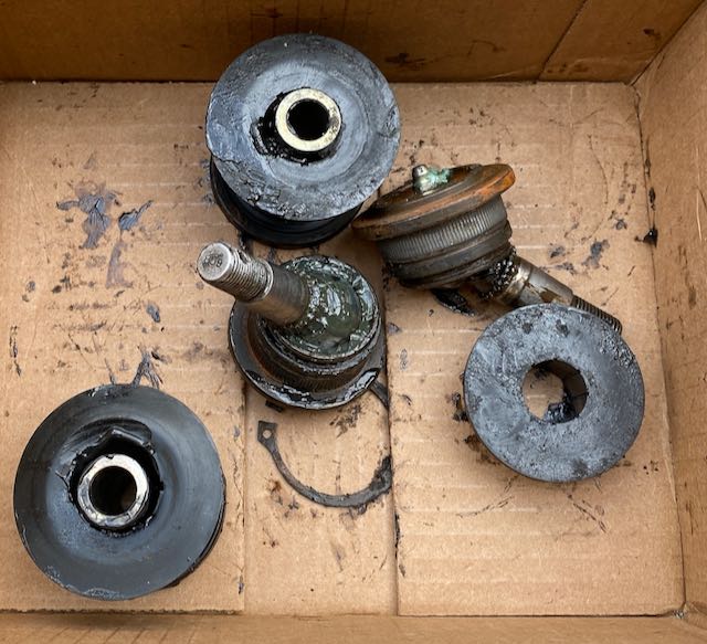

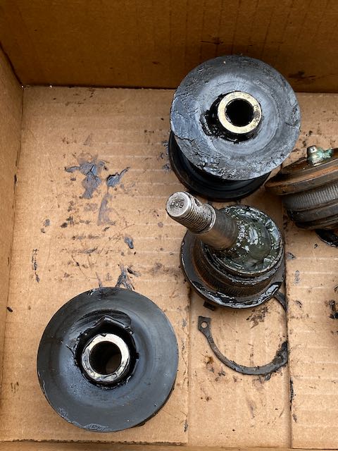

I know it' an old thread but I think my info fits in to this one.
After about 65K on my Camburg UCAs I decided to have them rebuilt. I've greased them regularly FYI. So I called up Camburg and ordered all the replacement pieces which includes the Moog balljoints, bushings and zirc fittings. I had my mechanic install them and provide me the old ones.
Pictures attached for reference. Mechanic said the ball joints were bindings at certain angles. Additionally as you can see the bushings are worn in the center on one side.
Hope it helps.

When you greased the bushings, did you loosen the nut on the pivot bolt? Kind of looks like you didn't but I wouldn't know.
