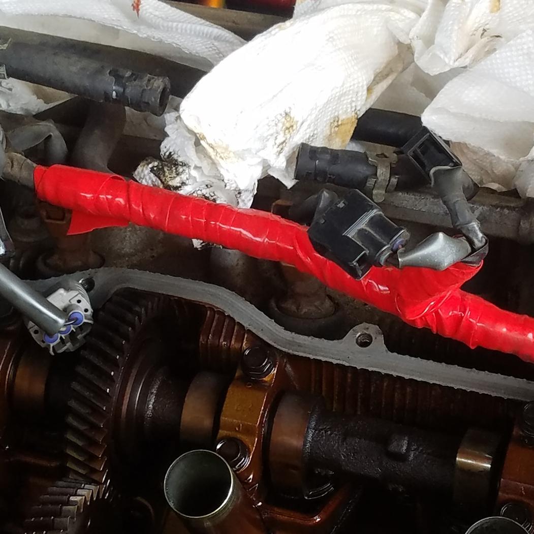

For the dreaded “plastic loom” or wire cover over the top of our engines, I had mine shatter like an eggshell when replacing the VCG’s. To solve this, I vacuumed up all the pieces and turned to something called “rescue tape”. It is a very high temp, “self-fusing” tape that has worked like a charm. There are other brands of this kind of tape (Walmart sells a Rustoleum brand of this stuff) and it really holds up. The tape stays pliable but fuses/bonds together really well. It is such a high temperature tolerant tape, it does not melt or scorch even on top of my hot engine. So, for those looking for an alternative, this stuff works!
And yes, the bright red is all I could find at the time. Would have preferred black but couldn't find it. I do know it comes in clear, black, red and even yellow.....
