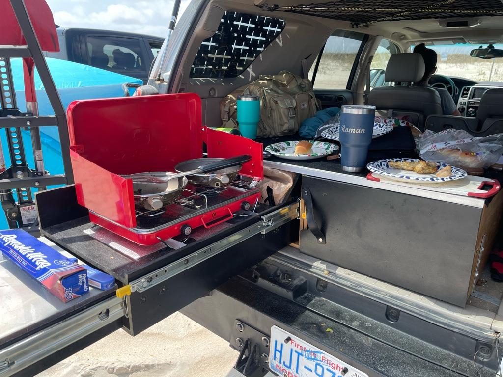

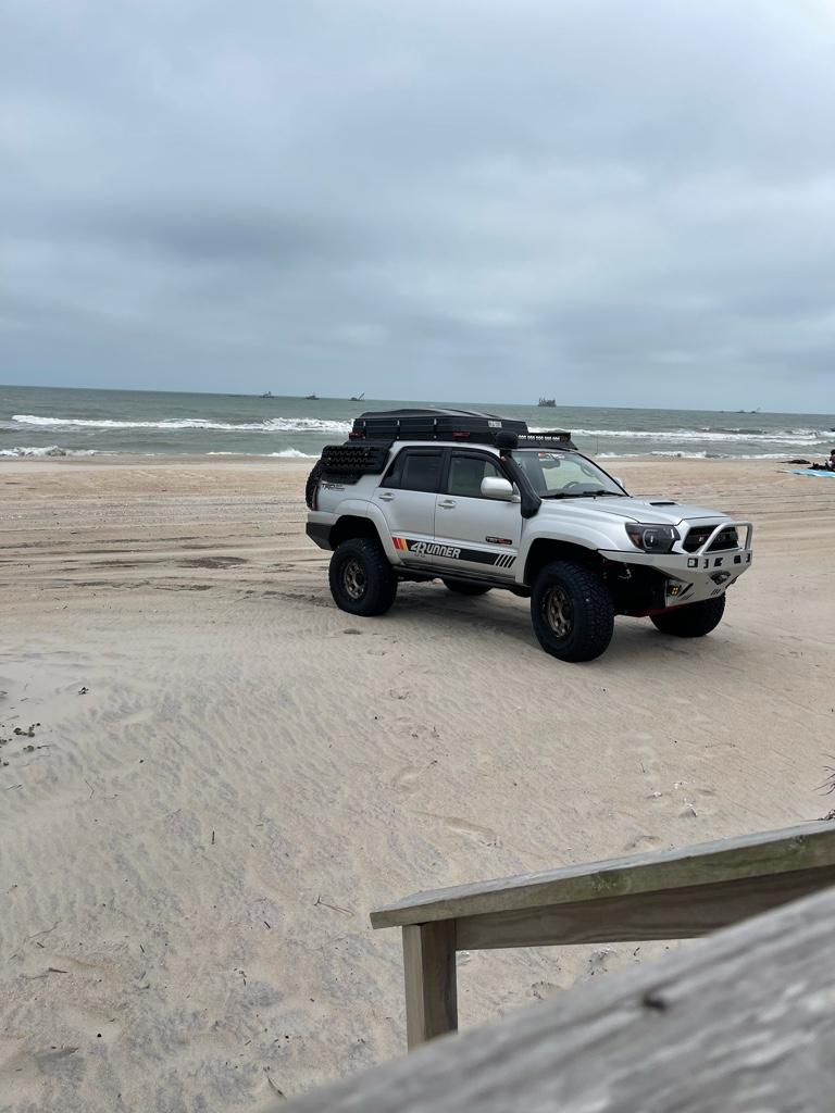

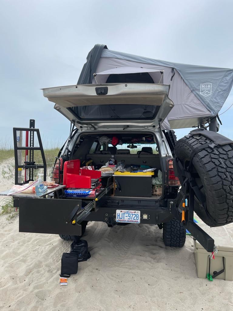

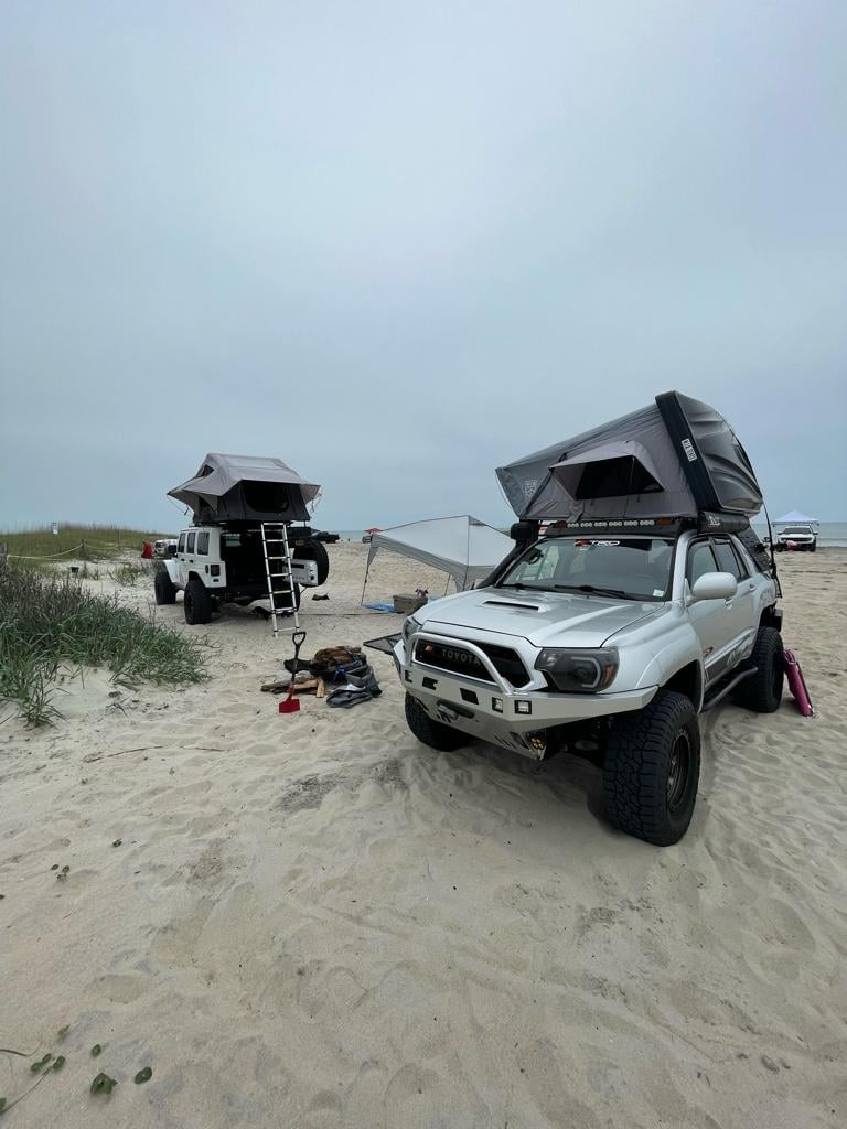

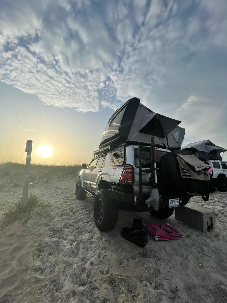

I'm sure there are 1001 ways to do it, all with different budgets as well, but what I'm running on my 03 is a Costco-branded MIA Outdoors hard shell RTT on top of my prinsu-style rack with a smaller awning on the drivers side. The tent opens towards the passenger side. Having a hard shell tent was a game changer since now I don't have to worry about taking it off every time we aren't camping. Sure, its added weight, but its significantly lower profile than a regular RTT and I don't mind the look of it up there.
Set up and break down on a hard shell is also super quick compared to my previous smittybilt RTT I had.
For the rest of the build I am running a drawer system I built via plans purchased from adventureindex. I have a gas stove tucked away nicely with all of our camping goodies in there. Makes it really quick to pack to get off road. I have a ton of other (arguably un needed) overlanding equipment that gets shoved back there as well. It's worked out nice for me so far. A sleeping paltform build is also very doable and I see a lot of folks run it. I just like the idea of sleeping in a more comfortable setup tent, that isn't on the ground.
Really nice build you've got there! Thank you for the feedback - drawer system is a must for me in this case as I'll be able to stuff all my equipment in there - rear of the rig is not gonna get much use as there are just two of us that do get on the road in this thing. Still waiting for my Victory 4x4 rear bumper - swing outs are here, still missing the bumper itself - awning is a nice touch too and is on my list. A lot easier to install with hard shell IMO.
thanks again for your feedback - these are the kinds of things I was looking for to get ideas of my own.

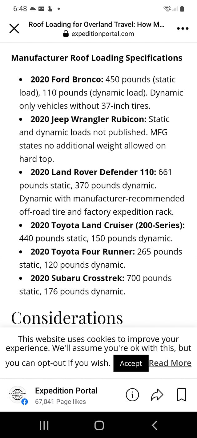

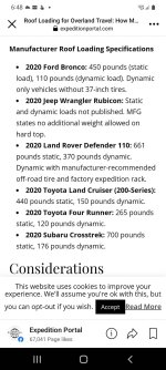

Morning fellas,
Please be aware of your roof loading on your rig. At a quick glance, looks like a 2020 5th gen has a dynamic roof loading of 125 lbs and a static loading of 265 lbs. I wonder if our owner's manual has this info? Hopefully our 4th gens have a higher rating than a 5th gen since manufacturers are going toward lighter and stronger construction these days for fuel econ and crash rating.
It's the dynamic roof loading that's more important since this is the weight the roof is suppose to carry while the vehicle is moving.
A RTT can easily weigh more than 125 lbs so please be aware of not overloading your rooves! Stress cracks may occur if the roof is overloaded, not to mention if you're involved in an accident, your insurance company may throw a fit.
Just making you folks be more aware!
Cheers.
