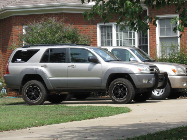

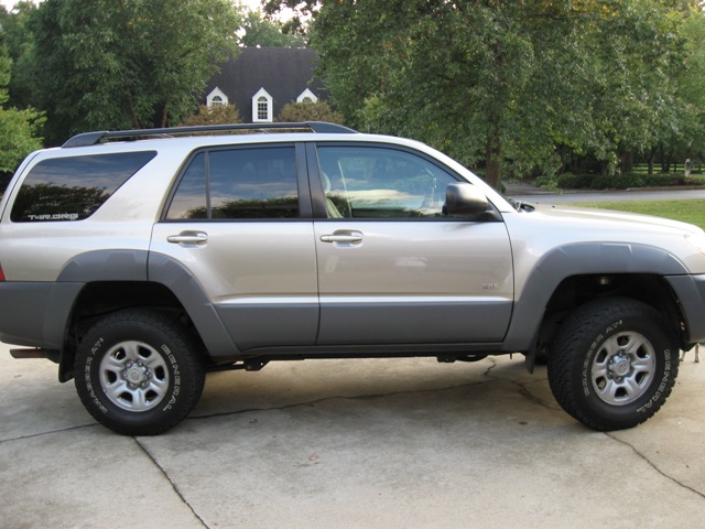

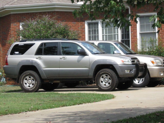

could someone pleas fotoshop these wheels onto my 4runner..... dead serious about ordering these.... they are hub centric too.
heres some pics to work with. thanks
If those are pro comp wheels you want lug centric NOT hub centric! That's straight from pro comp! Their hub centric wheels are to small for 4runner hubs! Get the non hub centric wheels and get the ultra e.t. Spline drive lugs from wheelers offroad!
that looks sick thanks guys i really want them now... and why not hub centric???? thats what the hubs are so why wouldnt i get hub centric??
Because pro comp hub centric wheels will not fit on an 03-09 4runner! The center of the wheel is smaller than the 4runner hub! That's what pro comp says!
well they should cause toyotas are hub centric and this wheel comes in hubcentric and lug centric. ppl always talk about how u should not get lug centric unless u put regular spacers on first that are not hub centric. so thats why i like these and they are a good price... but if u really want to foto shop some more i will find some others that i like too. how do u foto shop anyways... do u have special application??
try these
pro comp extreme alloy 7189
and if u really like to foto shop stuff here is another for practice haha
helo he842
Yep, non hub centric no problems! I would recommend getting the ultra e.t. Spline drive lugs though, they have and extra 1/4in shank for more thread contact! Do a search on toyota 120 there is a whole thread on there about pro comp wheels specifically! That's how I found out about the lugs from wheelers offroad.
From what I've found out the standard conical lugs only grab a 1/2" of the stud because the front studs are shorter! The e.t. Lugs work more like the factory lug, and no the factory lugs don't fit the aftermarket wheels! They are $1.50 each and $5.95 for the key for the spline drive
do u think if i bought the non hub centric ones and took them to a tire and wheel shop they could do it for me as i dont want to try to bother with it and accidentally buy the wrong stuff? thanks
and thanks again amsport..... i still like my first choice the best and there the cheapest :) but now i just gotta figure out how to get em on haha
okay well i think i will order them and then take them to the shop and see.... they are pretty good so i think they could do it. and if they dont have the parts i need ill just order them.

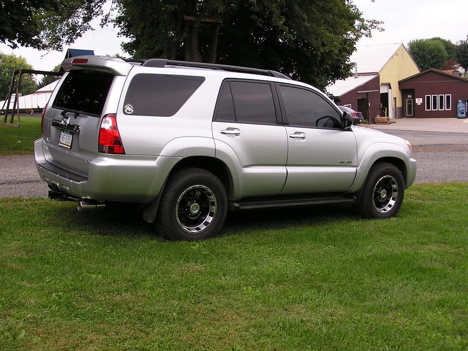

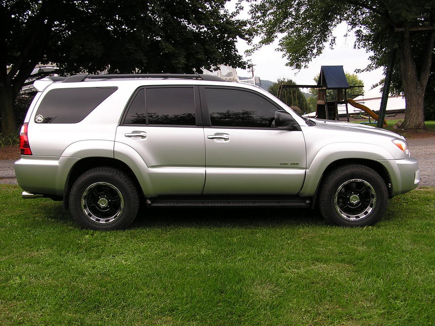

just came across ur post. i have these on my 4runner. i think they look pretty good. If i remember they are the lug centric ones andd i had to purchase extended shank lug nuts from Gorilla Lug Nuts.
