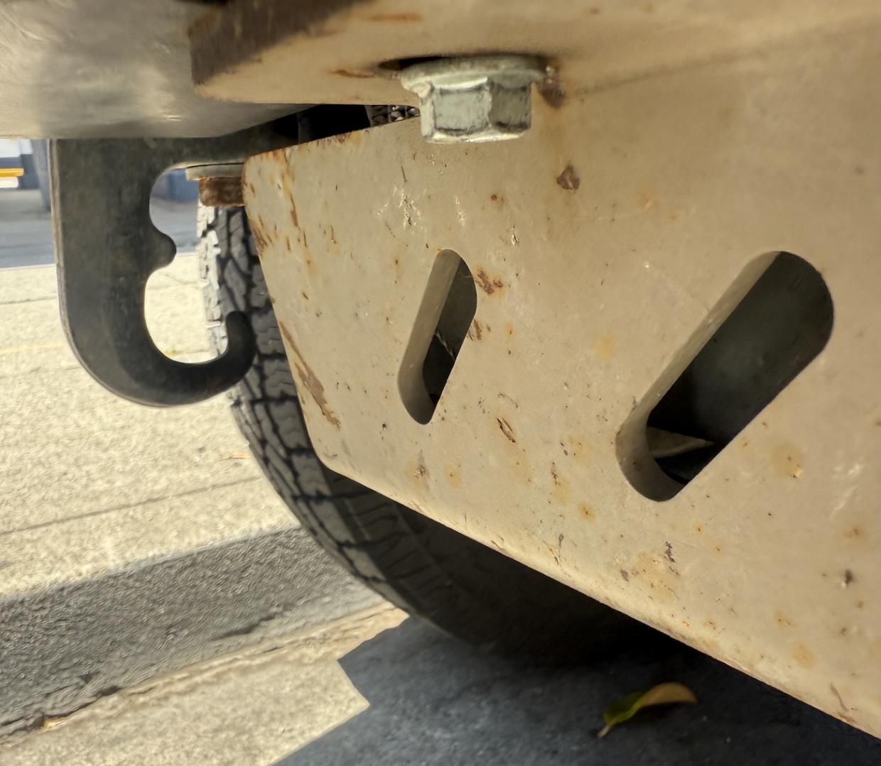

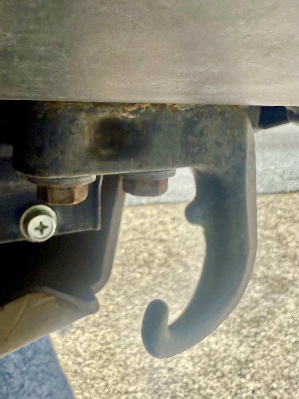

Happened to be out by my rig and took a couple shots of my factory hook....
