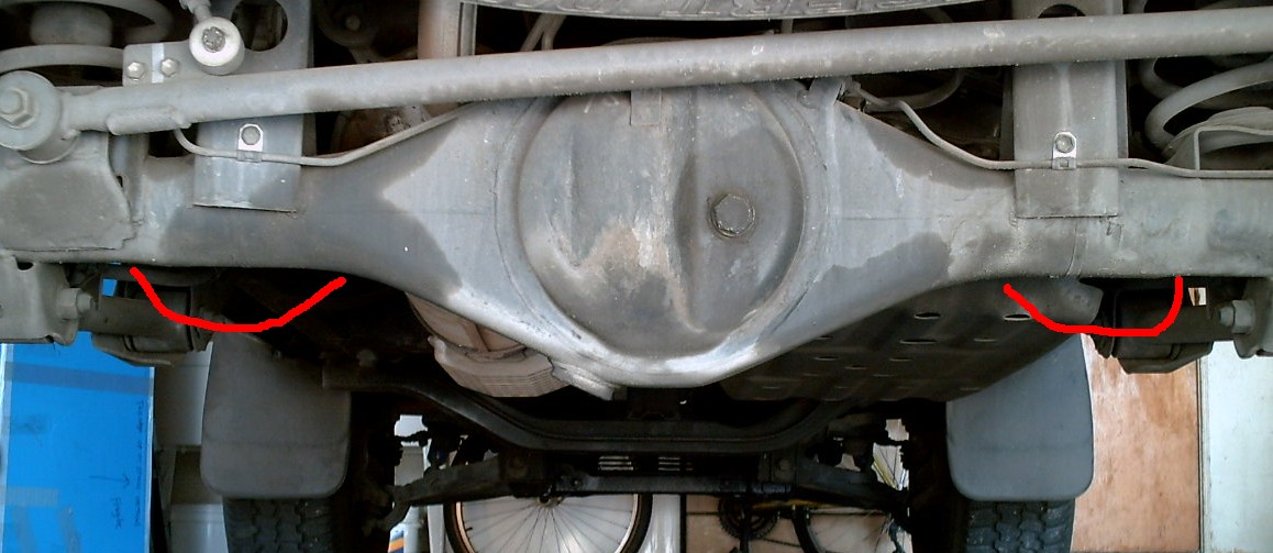

A AftRunner New member Oct 22, 2006 #1 Hi all, I have a '91 4R - Is there any problem with supporting the rear of the car on the axle housings at the red-highlighted locations in the pic? Any problem with jacking under the trailer hitch? (with a floor jack, not hi-lift). Thanks Attachments 4r.jpg 131 KB · Views: 2,886
<<<< Senior Member Oct 26, 2006 #2 Suport under rear axle- YES, but under trailer hitch definately- No.
Uneek Super Moderator Oct 26, 2006 #3 AftRunner said: Any problem with jacking under the trailer hitch? (with a floor jack, not hi-lift). Thanks Click to expand... You'll want to place your jack under the diff (pumpkin) on the rear axle. Just make sure you clear the drain plug. The hitch is a no-no.
E Elton Banned Oct 26, 2006 #4 jack it up under the diff and put 2 jack stands where you have it outlined
