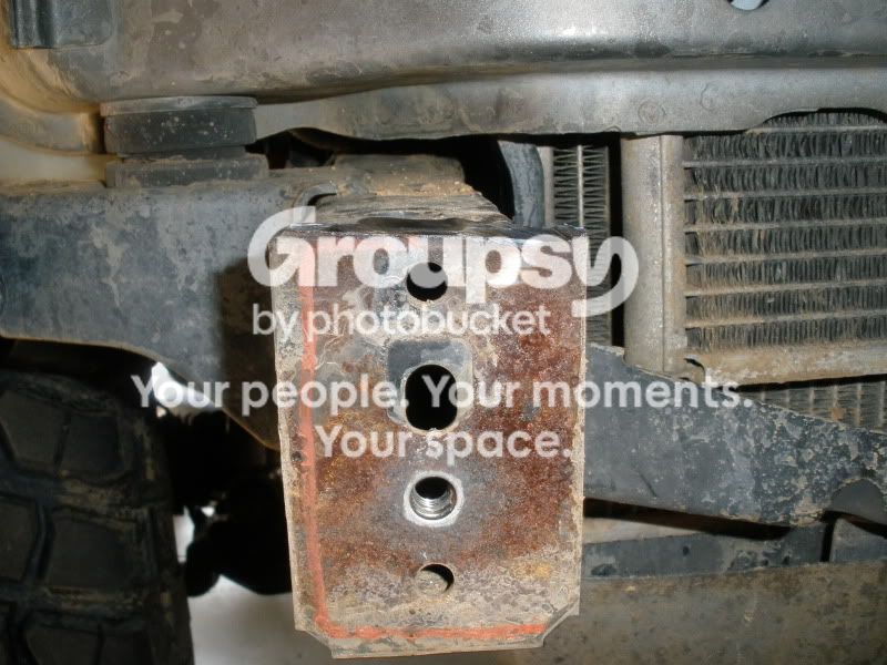

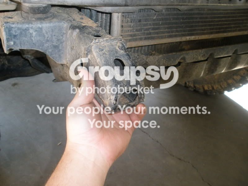

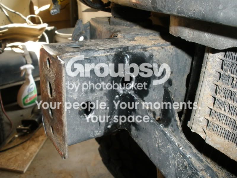

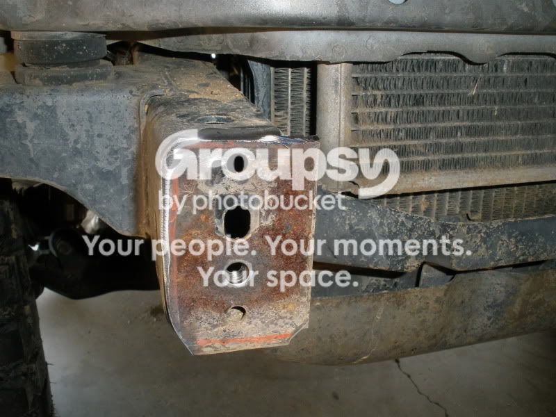

once you remove your stock bumper you will square off the frame horns. You will need to drill two holes on each side.. One hole is already there, just need to punch through the other side. On the rear bolt you will have to clearance the stock cross member to allow room for a nut.
On the out edges near the wheel well openings there are two brackets driver/pass that make a V shape. This will need to be removed. You can unbolt them or many others have just cut them flush. Here are some pics. I sent you a PM with my cell phone to answer any questions you may have. Since I will be away from the shop this holiday weekend.
