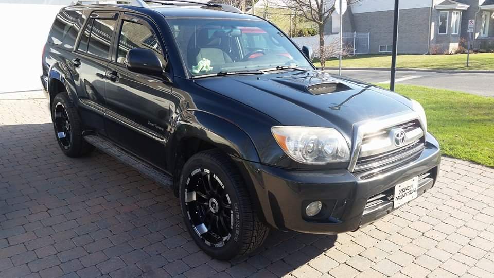

I am currently running 20x9 0mm offset with 265 tires. And it sits flush flush.
