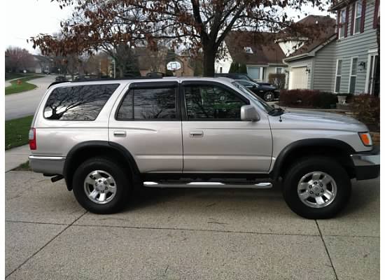

I really enjoy the looks of ours with chrome nerfs
I would LOVE some more options on nerf bars. I’ve called everywhere and the only nerf type bars I can find that fit my 02 are from Westin. Don’t want sliders, just steps but all the cool ones are for new T4R’s or Jeeps.
