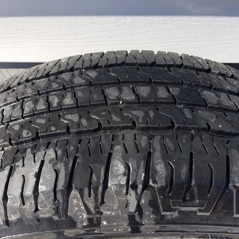

If you want a cheap set of good used tires, let me know. I have a set of 265/70/17 Goodyear Wrangler Fortitude tires off an F150 with about 35,000 miles on them. $150 for all 4 of them picked up in Jessup MD They still have plenty of tread, only replaced to go with a more aggressive AT tire. Just want them out of my way at this point!
Hey thanks, but I am from Southern California. I can't come over to get them from your location I guess.
