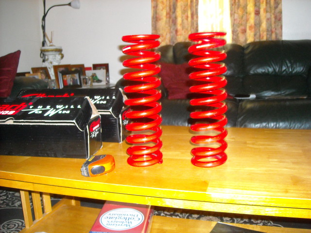

Can you identify these springs?
cj80cruiser
Senior Member
Can someone identify these coils?
650lb Eibach front springs?????
Find a 650 lb moose and have him stand on one of the springs, if it moves down 1", then you got the right ones!
There's a shortage of moose here in Alabama and I don't think my girlfriend would stand on them for me even if I asked her nicely. :biggrin2:
Let's say they are 650lb springs....Would a 13" spring provide 3"s of lift over stock?
I got confirmation that these are sway-a-way coils and that they won't work me. Why don't they work? Too large of a diameter?
Diameter is probably wrong. But the main reason is that the spring has been flattened on both the top and bottom. Stock springs are flattened only on the top.
