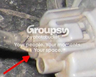

I need the part number for the part that connects to the socket 81515A

Are you talking about this?
4runnerturnsignalhousingdrSide2crop.jpg~original

I think 90980-11020 you are looking for.
I think that's what he needs. I know it's what I need. My truck (2005) has DRL, everything works, but one side has a different socket, lamp, and a two wire connector. The other side has a three wire connector.....:ybrick:
old thread but in-case someone stumbles on this thread like me, on my 2005 SE the FOG and Turn signal are busted up
Turn signal is: TOYOTA 90980-11020 HOUSING, Connector F
