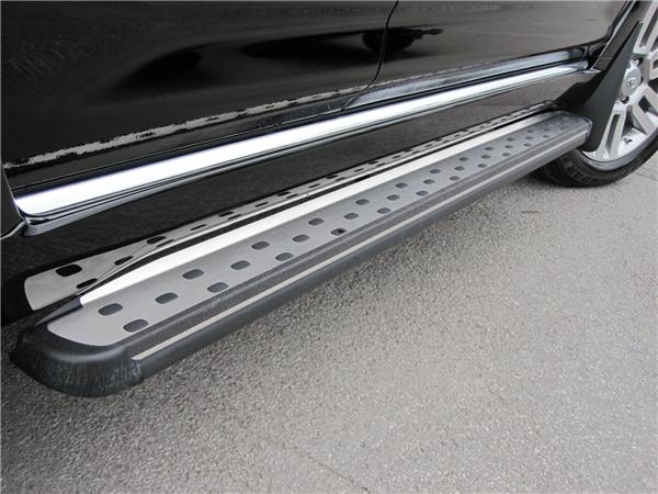

I notice on my 2010 limited with canadian running boards that the black anti-slip dots were starting to fall out.
I contacted my dealer here in Vancouver and they said that they are port installed running boards (not from the factory) and that they don't know where to get parts for them.
Has anyone else had the same problem with their running boards?

Here is a picture of the running boards:
http://www.toyota-4runner.org/attac...dian-running-boards-2011canadalesidesteps.jpg
Its those black dots that have started to fall out. I know that it will be covered by warranty. I was just wondering if anyone else had this problem and if they had a solution like a part #.

I'm having the exact same problem. It's quite annoying. That and the fact that the running boards are suuuuuuper slippery when it is wet.
ahhh OK. those look nothing like my running boards. The ones on my TE provide good grip when wet....

Good news I got the Anti slip dots for the running boards. The dealer tracked them down and called me within a a couple of business days. It was all covered by warranty and they gave me some extras just incase more fall out. Thanks to everyone that helped me out.
What do the "anti-slip" dots look like? (For those annoyed with slippery boards.)
There the black dots on the running boards pictured above.
Don't be fooled though, the black dots make it like a skating rink rather then water slide when your standing on them. They look good but traction is not key on the these boards.
