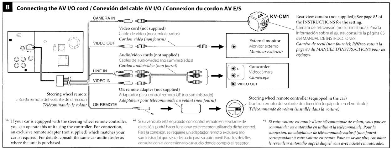

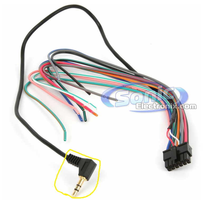

are you using the adapter with this plug into the harness... I overlooked this plug which made programming ineffective.
