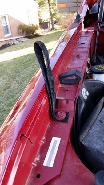

For hood tie downs, you could pop the hood and mount straps that come up through the sides.
They also have straps that you can just put in the channel, and close hood.
Amazon.com : Propel by Shoreline Marine Hood and Trunk Loop Kayak Tie Down Straps : Sports & Outdoors
Awesome, will be adding some of those.

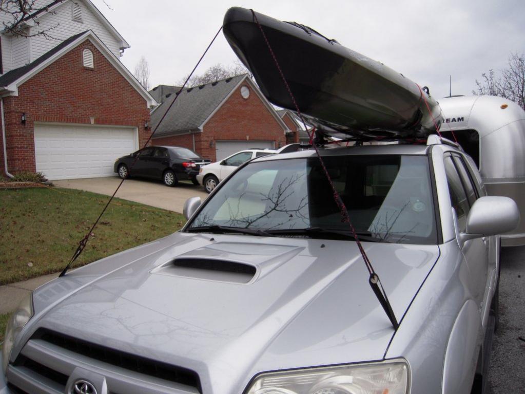

pDubs tie down solution is what I use. I had an old life jacket and I cut the straps off and used a grommet kit from Harbor Freight to put some grommets in them and used the bolts in the fenders to secure them. You just fold them under the hood out of sight when not in use.

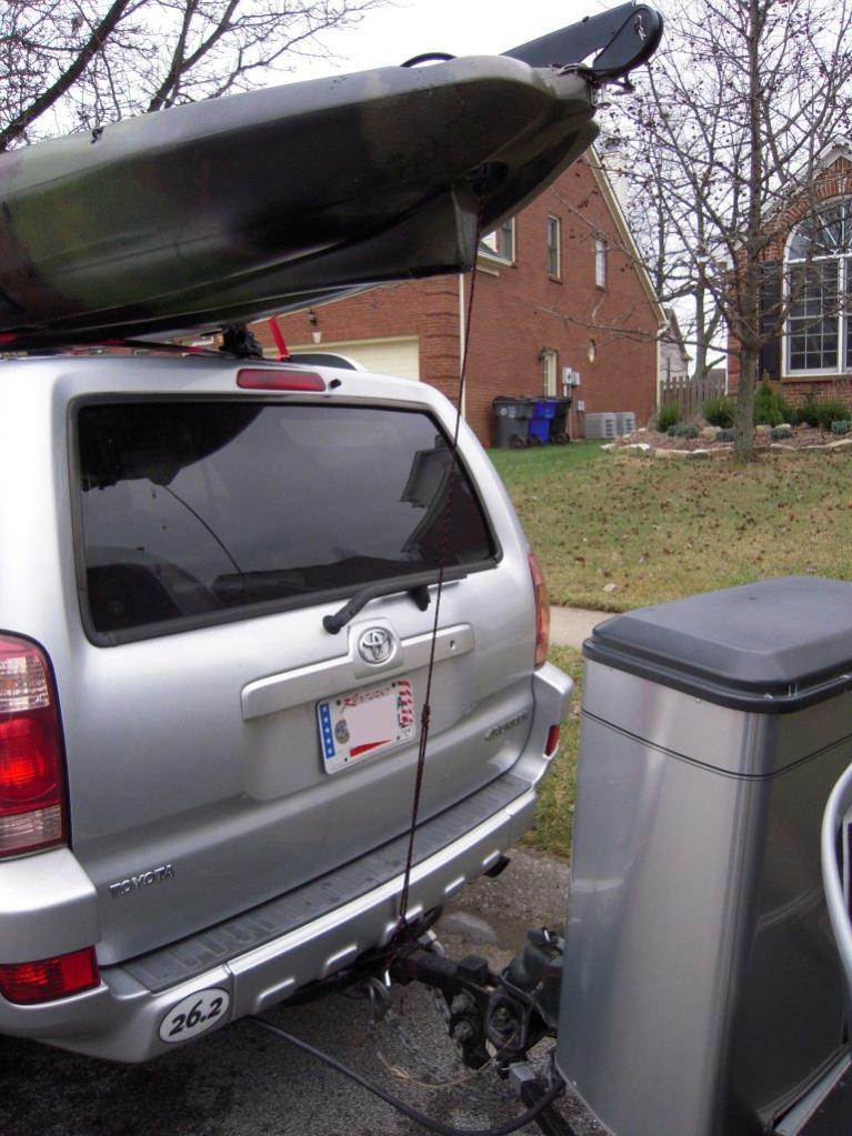

The front tie down it just to keep the nose of the canoe or kayak from catching air. It's aerodynamic enough to stay down but a gust can pop it up. The rear tie down is just for balance on the cross members. I use slip knots on both so I can easily adjust the tension. I slide the rear loop over the hitch so I can remove it to open the rear hatch.

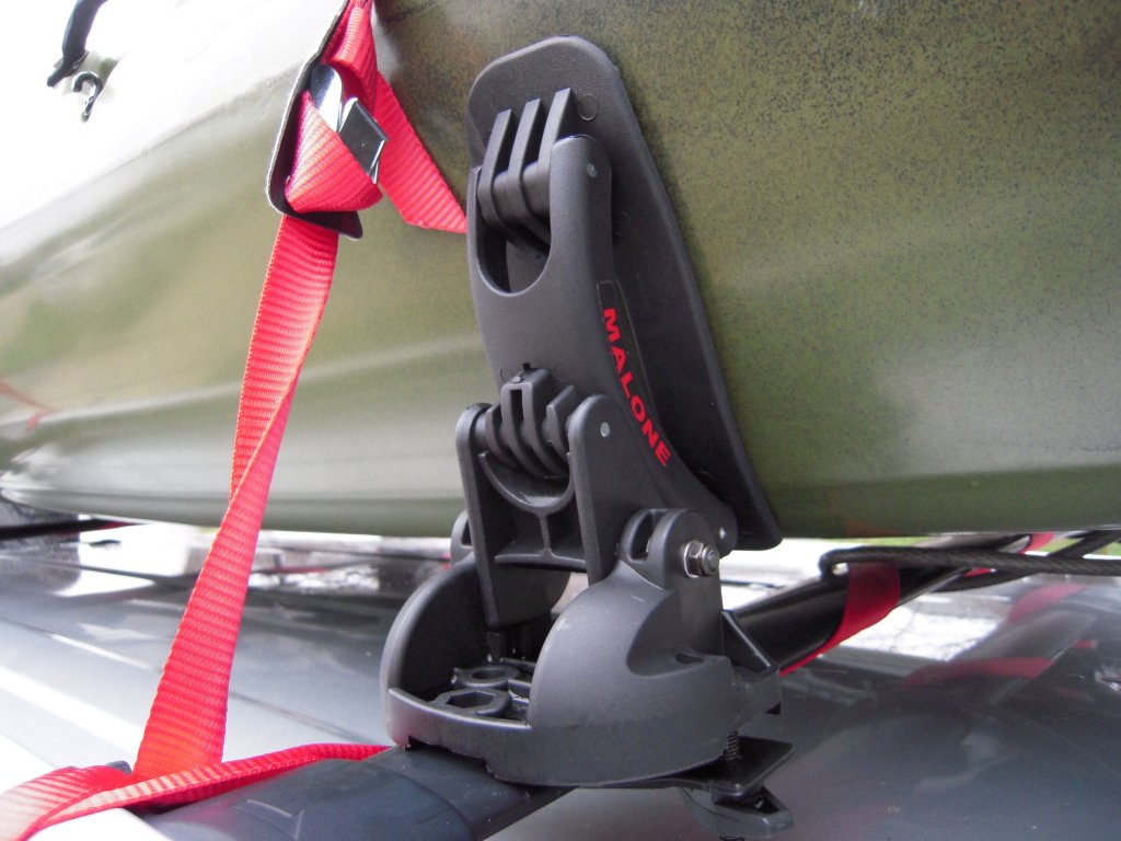

My 2004 rack has about a 130 lb. capacity (it's in the owner's manual) and my kayak is 92 lbs. I got the cross straps from Walmart. I use a wire cable through a scupper and lock it to the left rail. The 13' tandem kayak sits in Malone saddles. (Put a twist in the tie down straps to keep them from vibrating in the wind.)
I've carried it from central KY to central FL, across the panhandle to AL, LA, MS and over to TX. Then from TX back to central KY. I never had a problem.

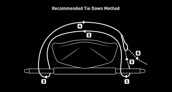

I do however, solidly recommend utilizing a better way of routing the straps around the boat. I know - everyone's own version works great. until it doesn't.
That's the routing I use, except at the end I have a buckle that draws it tight and I knot the tag end in a couple of half hitches on/near the buckle. I don't have a current pic. The one I provided in my earlier post is how I was doing it the first time, which wasn't correct. You also want to put twists in the strap to prevent the wind from vibrating it.
