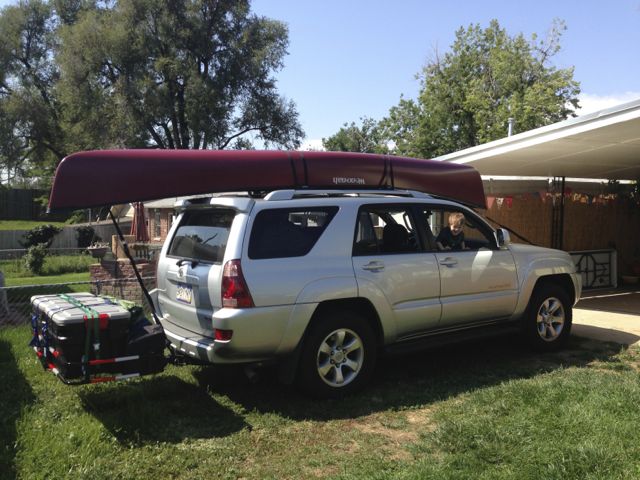

I know you have the 2006+ with the newer 'humped' spoiler but here's a pic of my 04 with these Yakima Gunwale brackets:
Gunwale Brackets | Yakima
The canoe is a Wenonah Aurora 16'. Not sure how yours would lie. I think you'd be ok though.

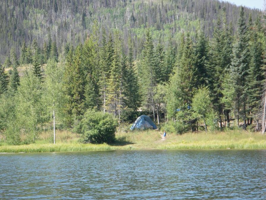

Also, a pic of the campsite. Looking forward to summer! Got my spots booked already. :)

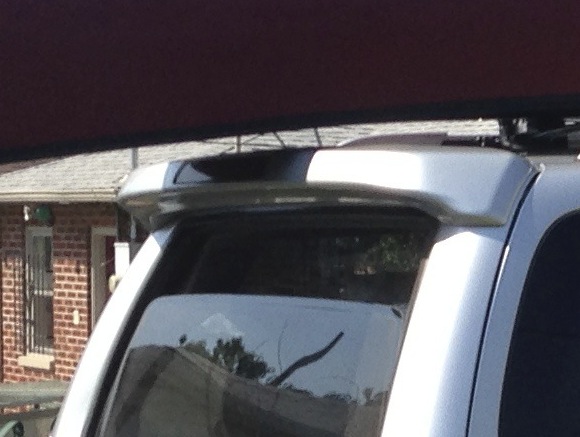

A cropped closeup.

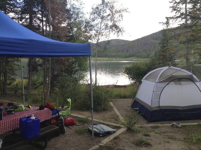

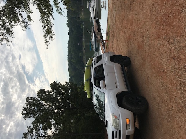

And another shot of the campsite. Because it makes me happy to look at it. :)
