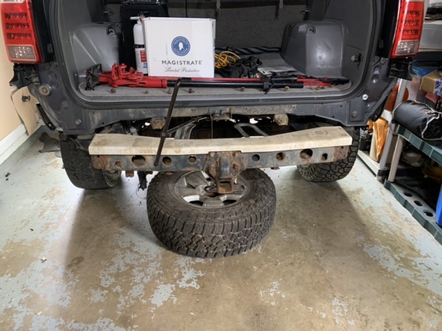

This is the bracket, just a few whacks with a hammer should do it.

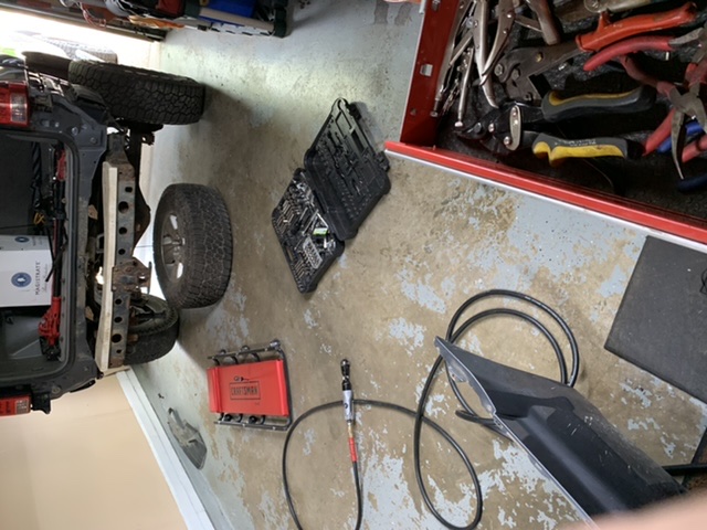

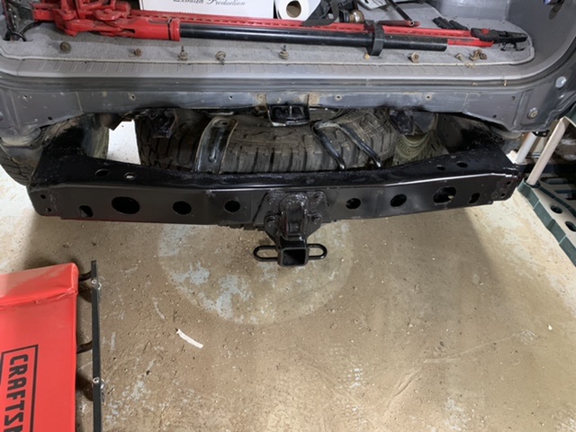

Thanks for the help guys. Finally got around to taking care of this. Pretty easy job but I went a few step further which took more time. I wire wheeled the rear cross member of the frame and did a little surface rust repair.

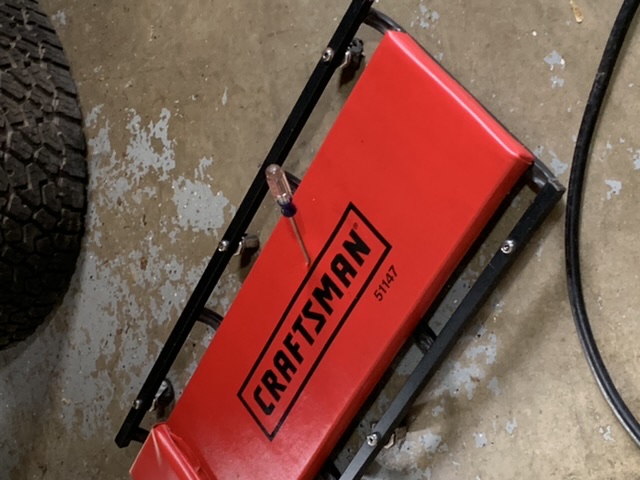

Also snapped a rusty bolt and had to knock the bolt head out of the socket with a screwdriver and hammer. On one hit, the screwdriver shot out like a missile and well... check out the creeper!
