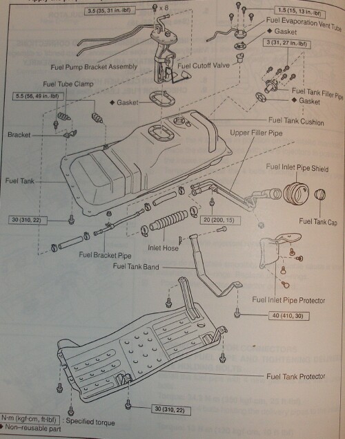

I am absolutely sure that I am not getting a full tank of gas. When I fill up it is only taking about 13 gallons. The gauge will only go uo half way past 1/2. I am thinking it has to be some sort of venting issue. Where does the tank expel air as it fills with fuel? Any ideas?
Im pretty sure the tank air is expelled through the same opening that the fuel goes in. I'll check the fsm tonight to confirm.

Air from the tank should be expelled through the small diameter pipe as you can see on the upper filler pipe. Fuel going in goes down the big pipe and the air comes out of the small one. There is a fuel evaporation vent pipe, but that goes to the throttle body on the engine to burn the fumes during combustion.
I seriously doubt that your tank is pressurizing itself during filling, but one way to double check if you want would be to disconnect the evap hose when you fill up.

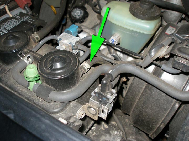

I looked at the canister and I noticed that there are 2 hose that come out of it going to metal return lines. One has a clamp and one doesn't. Anyone know which one I need to disconnect next time I try filling up?

Thanks now I know. I noticed ur setup is a little different then mine. I dont have hose clamps and I don't have that service port witht the green tip. I wonder if my canister is bad and that is why I also have a rough idle.
hmmmm i got more fuel into it without discinnecting that line. I think my tank is full....but still have the same reading. 2 different sending units with identical readings. What could the float be hitting?
