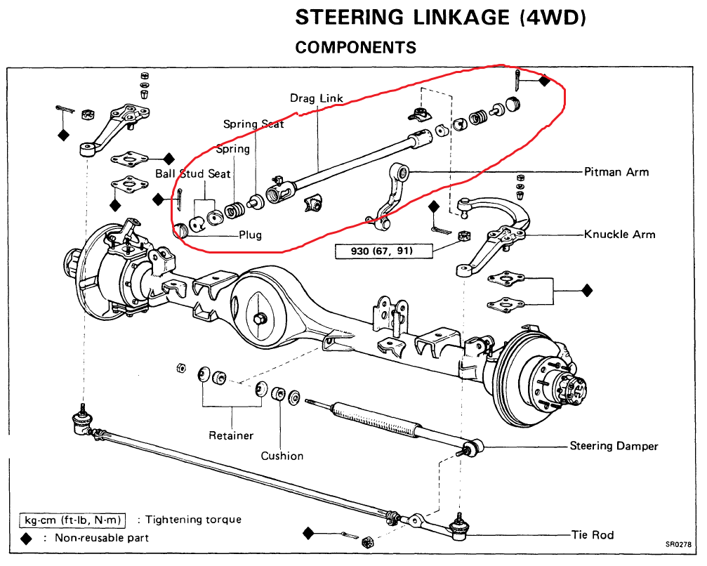

Before you throw any more money at the truck, find the trouble. Have someone rock the steering wheel back and forth while you look for slop. If I remember right you have stock steering? My money is on the drag link between the steering box and the J arm, that link has a ball and socket design on each end with adjusters. If they're even the slightest bit loose, you'll get steering play. The end links are rebuildable, the kit is cheap on Amazon or Rockauto. But don't do anything until you know what's causing your trouble.

Not an authority, had similar issue with 90 T4r 4x4; if you have not already done so, as KidVermicious mentioned, best to try and find the cause before hand if possible. In my case; blocked rear tires, lifted front end and check for play; side/side and up/down, problem became obvious, in my case, narrowed the problem down to 'idler arm', 'ball joints', and wheel bearing. Received a quote from shop along with itemized part list but decided on a 'do it myself'. Have average mechanical skills, and found the task somewhat labor intensive but not that difficult, no. Anyhow, food for thought?

So if your slop is in the steering box, then you'll see the steering shaft move and the pitman arm won't when your helper turns the wheel. If it's in the drag link then you'll see the pitman move but not the J arm. It could also be in the tie rod ends, or the rag joint on the steering shaft. It might help if you leave the truck on the ground, the resistance from the tires on concrete will make it easier to see the trouble.
If the trouble does turn out to be the steering box itself and you can't budge the freeplay adjuster, you may have to take it off and take it apart on the bench. You could just replace it, but what kind of fun is that?
