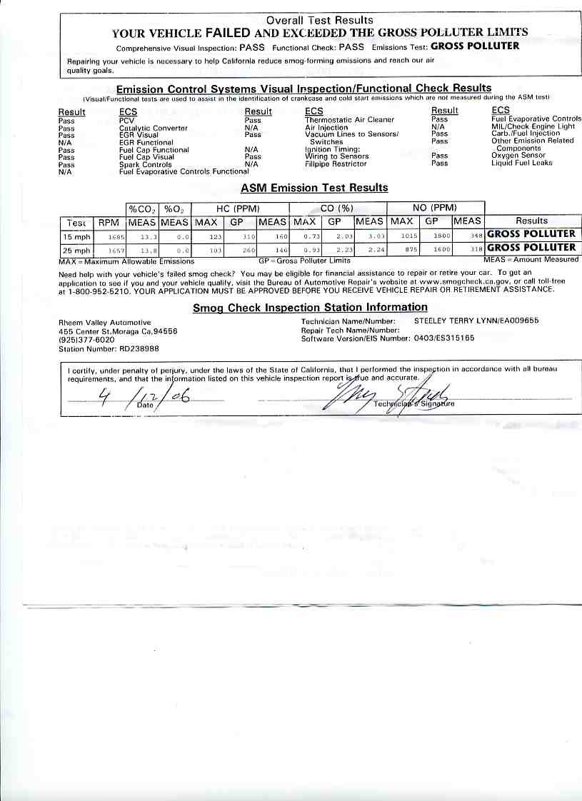

I have a friend with an old 4runner. He just got it smogged in CA before sale. It failed because of "Gross Polluter" . I attached the VIR to show the exact numbers. The HC (PPM) and CO (%) were what failed by a lot. Any ideas what the problem could possibly be? Anything that ussually causes these numbers to be so high? PLEASE HELP!
In case you can't see the picture......
HC max= 123 (15mph), 103(25mph)
HC Measured= 160 at 15mph, 146 at 25mph
CO max= .73 (15mph), .93 (25mph)
CO measured= 3.03 at 15mph, 2.24 at 25 mph
Thanks again
Thanks again
High HC (hydrocarbons) usually mean that the engine is not combusting all the fuel during each 4-stroke cycle. In other words, unburned gas always results in high hydrocarbons.
What year is the 4Runner? You might want to check the basics to make sure it isn't running too rich. Even something as simple as a bad oxygen sensor can cause the vehicle to run too rich, so don't rule that out either.
The good news is that the NOx is low, which does rule out the EGR system.
