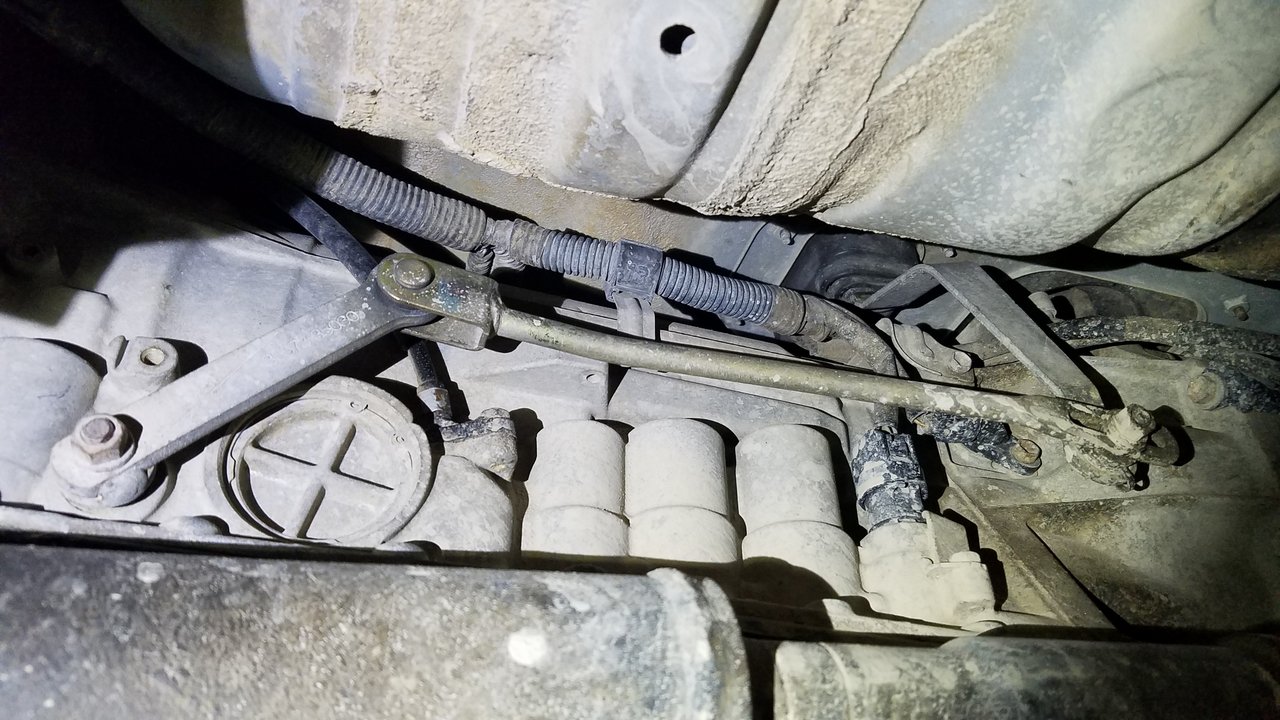

Is there a writeup how to check this?
Go under car where the shifter is, you can see the lever coming out of the black rubber boot on the right of pic (the front boot) and links with a nut to the rod that moves the transmission shift lever on the actual transmission. You may want to make a witness mark for that nut (right side of pic) so you know where it was. Loosen it and do what Bad Luck said above. If the lever out of the boot is all floppy then you could replace the shifter bushings. https://www.youtube.com/watch?v=gCHSRcq-LP8
Thanks I actually cane across that vid while searching around yesterday. Will try it asap
