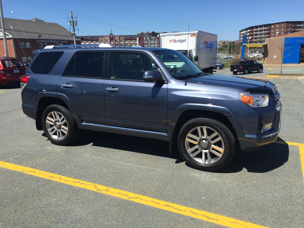

Surely there is water in his dorm? I’ll make this very easy for you. Purchase:
1) 5 gallon bucket from Home Depot or similar
2) a grit guard
3) Optimum No Rinse
4) Optimim Spray Wax
5) opti-gel if you want your tires to shine a bit.
6) big red sponge
ALL he needs to do is put the grit guard in the bucket and add 4 gallons of water along with 2oz of Optimum No rinse. Soak the big red sponge in this solution for several minutes. Then, all you do is wipe a couple of panels at a time, rinse the sponge in the bucket and dry the panels you just cleaned with a microfibre towel. I also clay and wax (Optimum Spray wax) every spring and summer and sometimes an extra wax mid-summer. I have done this exclusively on my 4Runner for the last 5 years. I live in Nova Scotia where the use of salt is huge because our winter temps/conditions fluctuate so much. Here is what mine looks like 5 years later. No bad eh? Ps- if you want to tarnish your paint, then ignore my post and go to the car wash.
