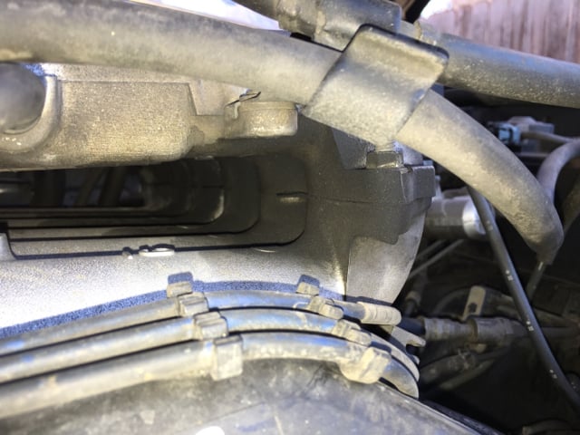

I was poking around my engine yesterday and noticed this...
I replaced my valve cover seals back in July and cleaned every part I took off, so this happened after that. I tend to take a look in the engine bay once a week, so it might be pretty new.
Any ideas what is going on, if anything?
Thanks!
Could be a leaking gasket at the point where the plenum comes together? The pcv valve is upstream of that which add oil and carbon to the air and it could then leak through the failing gasket.
Or your engine bay is just dirty! I'd clean it off as much as you can with a degreaser and watch it. If the grease comes back that gasket is toastamundo.

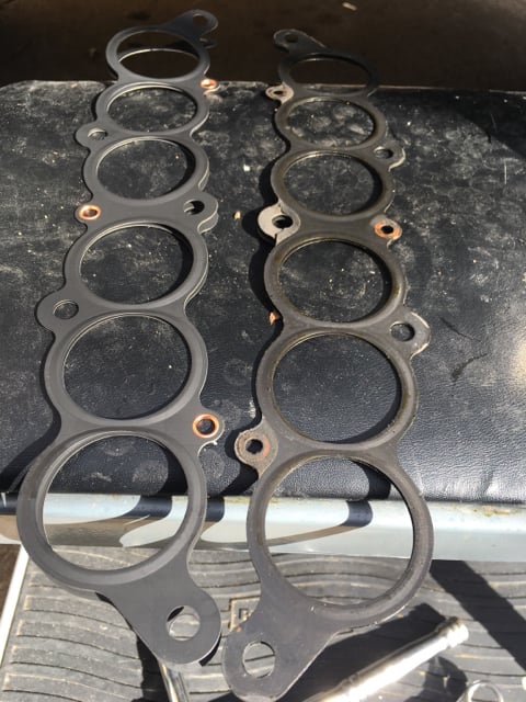

Finally got around to this today. Question; the gasket looks like two stuck together by some copper rivets. It's supposed to be like that, right? That is technically one gasket?

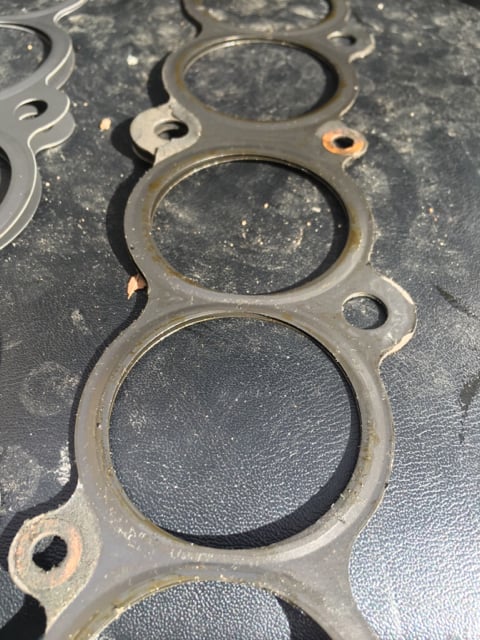

Here's a pic of old and new gaskets. Old one has oil on it. Is that a sign of something else bad or normal?
That is what the gaskets look like. The oil is probably from a bad PCV valve.
Thanks! I had to look up PCV valve in the ol' Haynes manual. It said valve cover, and my heart sank...until I read that you don't even need to do much to replace the PCV valve, right? Just reach in and pluck it off the valve cover and pop the new one in?
