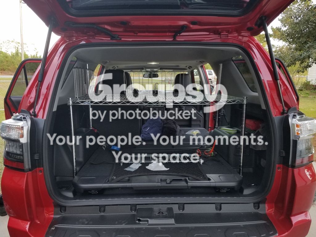

So, with that in mind, i decided i'd like a shelf in the back which allows me to utilize the cargo slide for heavy items, and space to organize smaller, lighter items up top, instead of just throwing everything in the cargo area. This is a first iteration, so i'm open to ideas and suggestions.
Current design uses 4 legs. My initial plan was to utilize the pockets which hold the factory cover, but i had a hard time coming up with a good solution which would be stable, noise free and still hold weight.
Initial fitting:
20161026_181433_zpsmggkewer.jpg.html

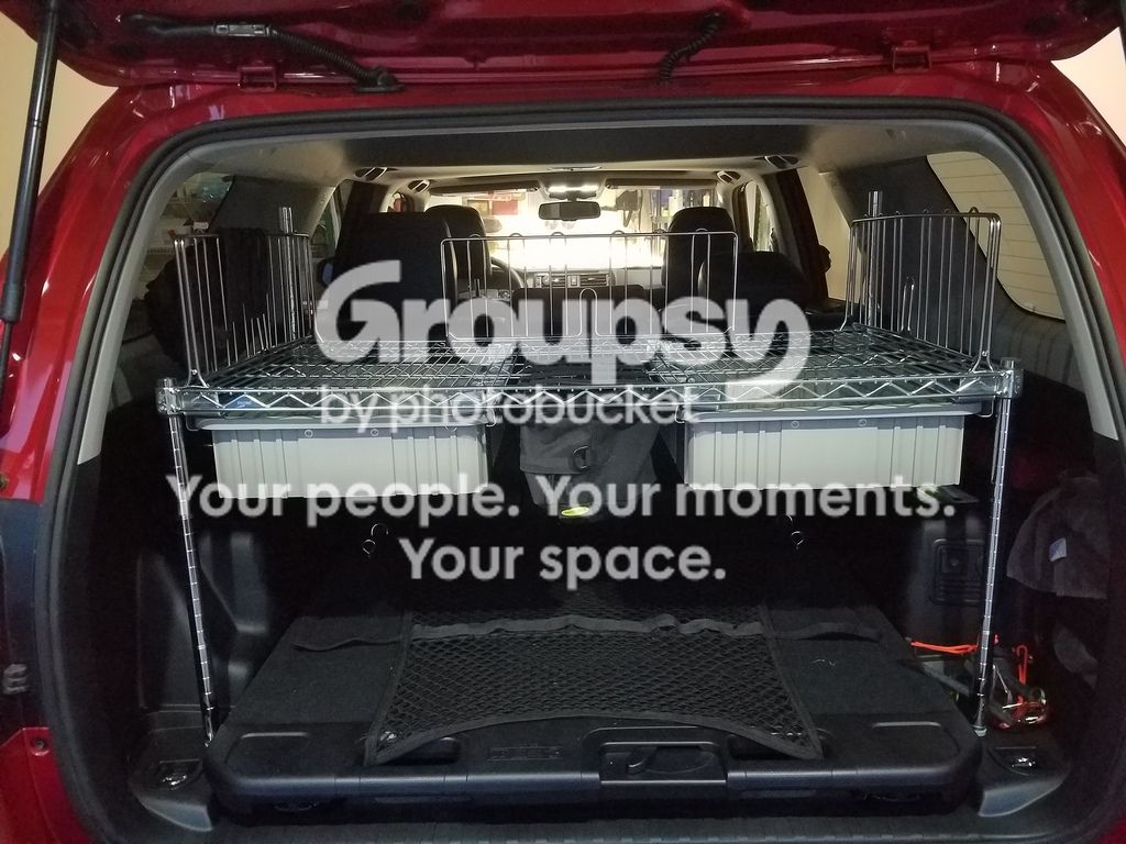

The rack design allows for easily attachment of some molle bags, plus strapping items down if needed.
20161026_185008_zpsnv2wupd0.jpg.html

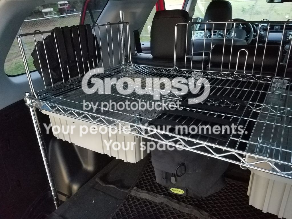

Finished product for now. The vertical pieces are movable, also thinking of replacing the one in the middle with one about 1/2 that height.
20161026_185930_zpsfbr2tvxc.jpg.html
Also, being an "off the shelf" shelf system, it's very modular and with many accessories available.

Initial fitting:
20161026_181433_zpsmggkewer.jpg~original
20161026_185008_zpsnv2wupd0.jpg~original
20161026_185930_zpsfbr2tvxc.jpg~original
I have that rack in my coat closet! My observations in there....
1) The plastic cup thingies that hold the shelf can dislodge under heavy loads.
2) I'd suspect it would be noisy
3) I'd question sturdiness. Isn't it rated at something like 200lbs stationary?

Looks noisy
These were a few of my concerns as well. I'll get a better pic this week, but as noted above, the whole unit is tethered down to the 4 tie-downs with steel braided cable to a turn buckle, attached to the corner of the actual shelf. This ensured the shelf cannot lift up, releasing it from the plastic retainers.
Noise was also a big concern. I can't deal with rattles. The main issue with these is the "resonance" of the horizontal shelf. If you've had one of these shelf systems before, you know, when empty, the shelf is noisy. I've been happy that is been 99% quiet once lashed down. The vertical pieces fit in tight and don't make any noise. The "slides" for the drawers aren't the best fit, but I tightened them down using some cut rubber hose to eliminate the metal to metal contact. My next solution, it was noisy, was just to weld it all together. Hasn't come to that yet.
The shelf is rated for 800lbs according to McMaster-Carr. Of course, I have no plans to get anywhere near that. This weekend it held 2 bookbags, a blanket and a pillow while the bottom was filled with 3 people's luggage for the weekend. The things is actually way overrated for anything that will go back there. I'm more concerned about the legs punching holes through the plastic they sit on than the shelf collapsing.
we use a lot of stainless steel metro racks labs, you're right about the weight rating (well i don't know about yours specifically, but that's in the range for metro brand) but if those legs go out of square at the bottom they can fail.
