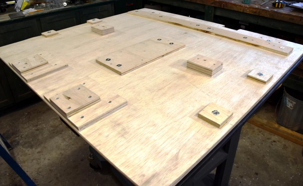

We just finished up on building a base plate to securely mount our fridge and drawers in the back of our 5th Gen. We looked at the commercially made ones that sell for $500 but decided to build our own for less than $100. As soon as we have the video edited and uploaded to our channel we'll share it here.
Meanwhile, here's a "teaser" pic:
Here are a few more pics taken during the build.
The underside showing the bolt-down and attachment points.

Looks really good, have you thought about measuring your spacers and sharing the design?
