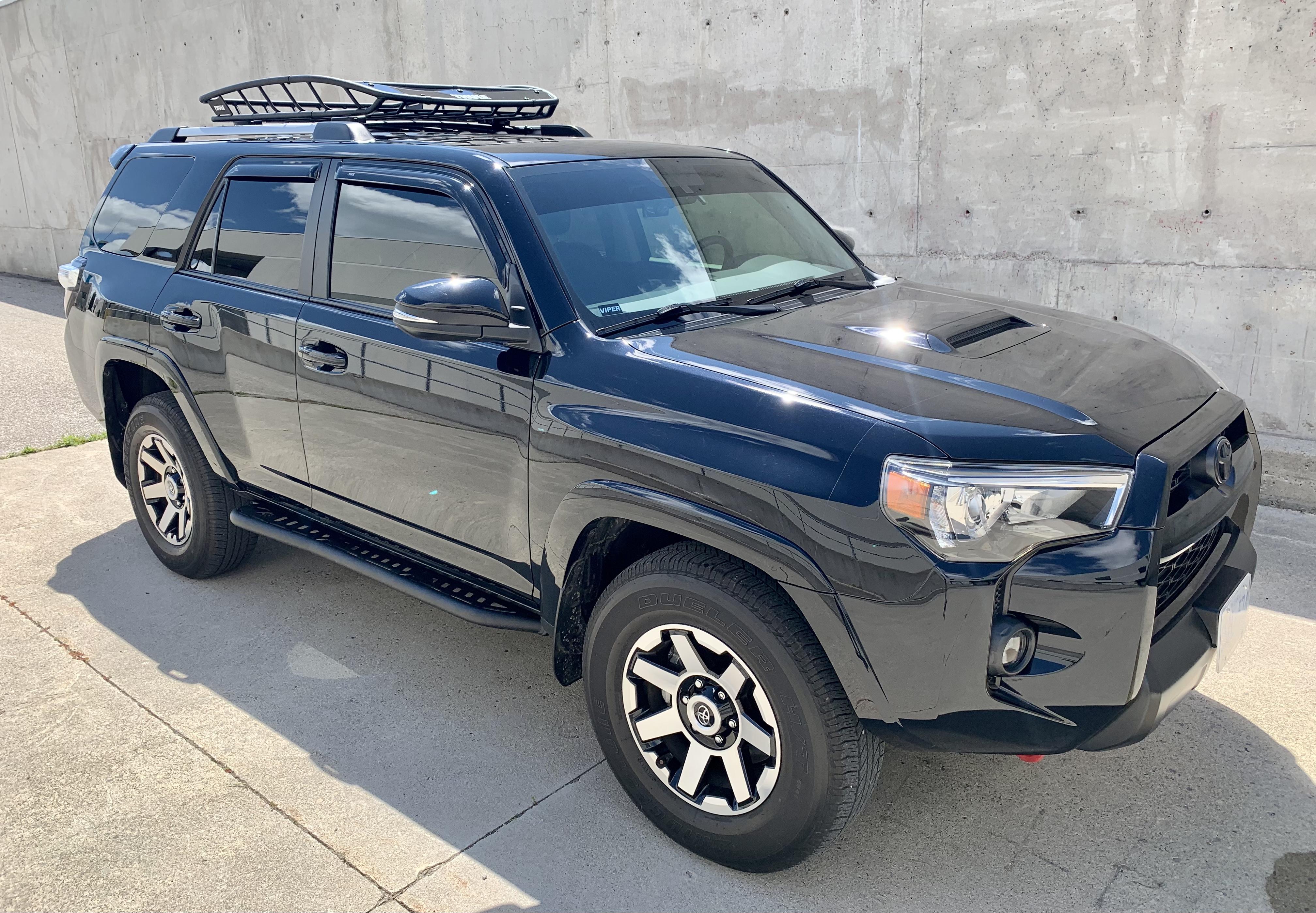

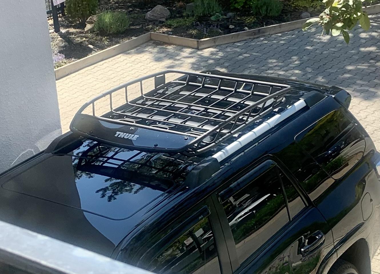

Not sure how much weight I’ve had up there but no problems experienced. Tents, chairs, my BBQ all tarped up, that kind of thing. I use 4 factory cross bars under it, had two given to me so why not. No clearance issues with basket brackets, all seems to work well. I presume a box mounts in the same manner with those clamps? You reach inside it ? Not sure.

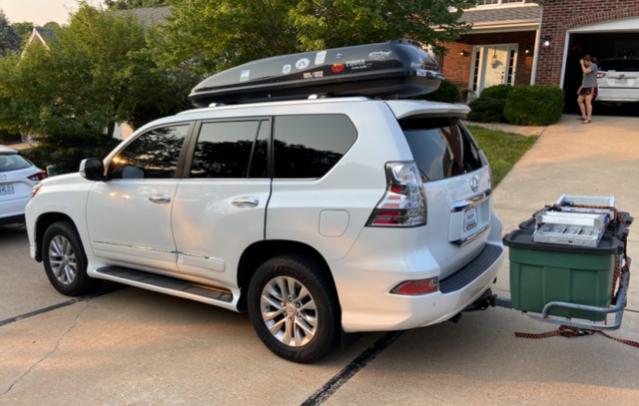

Toyota / Lexus are just about the same
I took this 'Toyota' to Florida and back at 80 mph. 1000 miles each way on factory roof cross bars. For the best results I spread the bars as wide (front & back) as possible.
If the factory Prado 150/GX works... the 4Runner will to. (My sister-in-Law had a shorter, cheap Sears box on her 18 4Runner Limited on the same trip)
