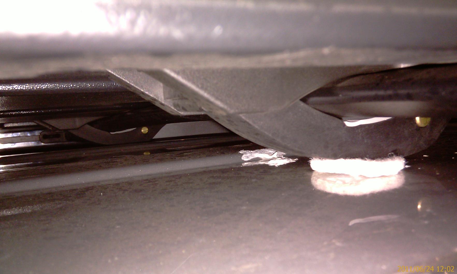

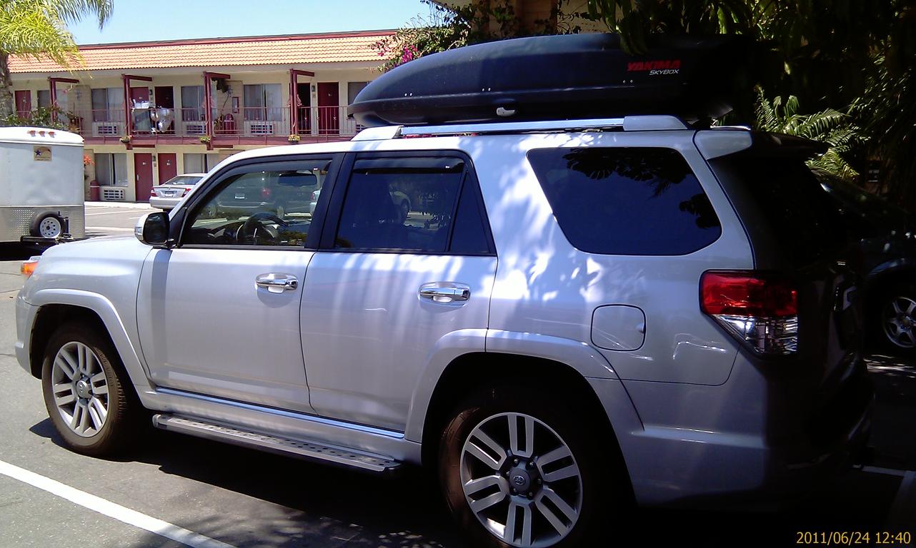

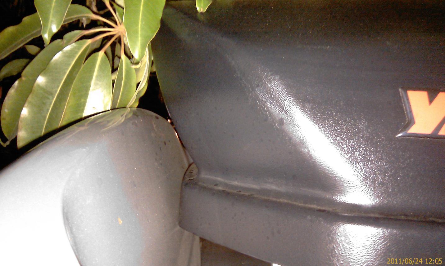

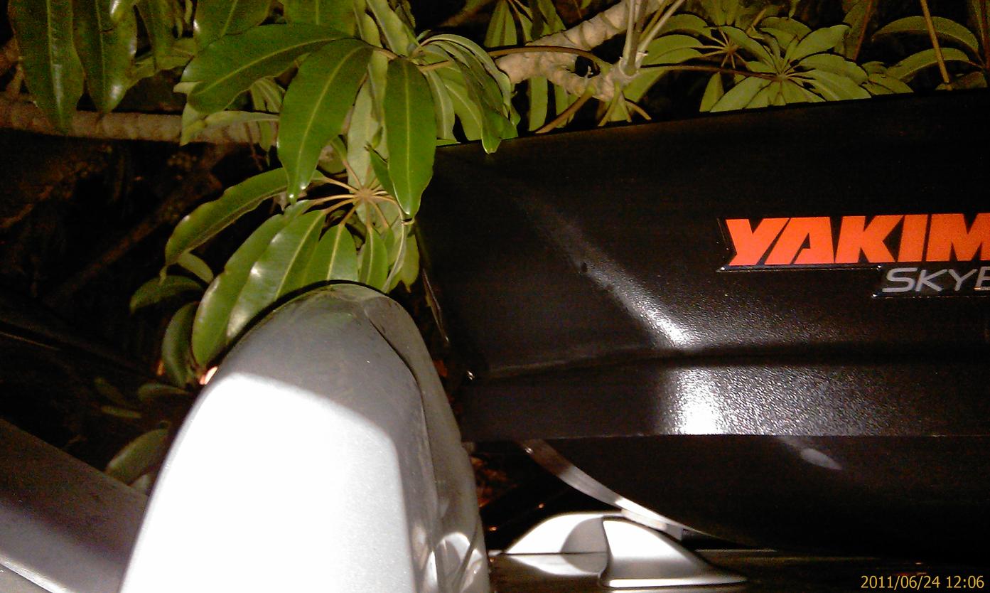

Yakima Skybox 16s (Black Color) Installed
Hi Everybody,
I finally bought Yakima Skybox 16s (black) from a reseller in Oregon. They have 20% discount, I paid $368 only, they also help me to check if this works and put it on the roof for me.
I have 2010 4runner (imited model) of orginal Toyota cross bars. These Toyota cross bars have small clearance between the bar and the roof. I installed the Yakima box very hard to avoid scratches on the roof. You better put a rubber mat on the roof before install it for the first time to prevent scratches.
I upload some pictures so that you know more. You can see that I put some "pad" to prevent the Yakima clamp to touch the roof.
When I open the tail gate, the spoiler touch a very little of the box. It is acceptable, does not hurt anything on the spoiler at all.
The big "Shark Fin" still have 1 inches between the box and itself. I also put a "pad" to prevent it the potential scratches.
For sattellite reception after puting on the box, there is no interference at all. I drove all the way from Oregon to California and turned on XM radio for 4 days test. The radio is clear all the way on highway. It just looks the same as before.
There is no wind noise in highway (I drove 75 mph, 130KM per hr). The box is still very stable on the top.
The major concern of using Yakima or Thule on 4runner, it is very very difficult for you to install it without scratching the roof !!!!! You need to put a thin rubber mat on the roof before you install it. In long term, you need to put on something (e.g. 3M protection film) to avoid scatches.
I don't recommend anyone to purchase orginal Toyota cross bar since it has lots of problem to install roof box due to low roof clearance between the bar and the box.
This is a definetly design problem that Toyota does not think much detail of the usabilty of such cross bars.
The good thing of the cross bar is just to fit into the rack and it makes the roof has lower centre of gravity together with the car.
Hope this give some ideas of those want to purchase roof box.

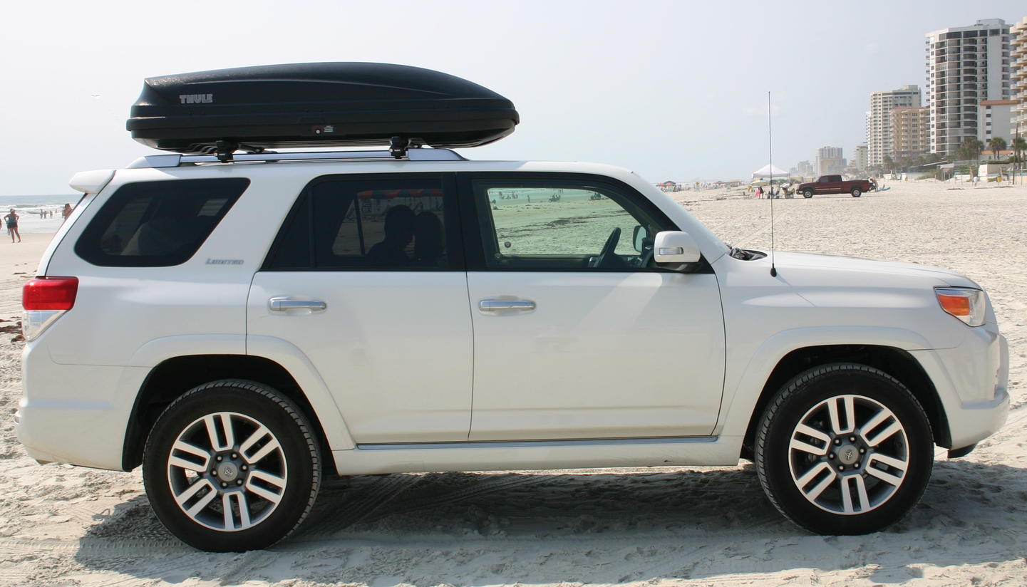

thule
mine worked great and there was enough clearance for satellite antenna. ( Daytona beach trip)also plenty of clearance for the tail to open

Roof Box Works Well Only in Non-Toyota cross bars
Hello,
There reason why it works so well in your 4runner is because you used Non-Toyota cross bars. These kinds of cross bars has highter roof clearance (i.e. the length between roof top and the bottom of the cross bars), therefore, you can easily slides the box into it.
So, don't buy Toyota cross bars which creates problem in most cases.
