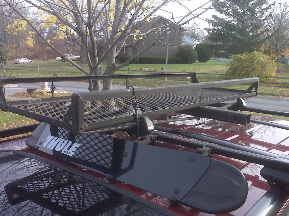

Here's where mine is stored from opening day of archery season... until I kill something!!!

Simple yet brillant, now why didn't I think of that??? I've found several of those type for $50ish, and if strapped down I don't see any harm in it being stored there. Do you guys think there would be any issues with the factory roof rack?
An elegant solution, just be careful when putting it up there, and removing it, so as not to ding the roof.
