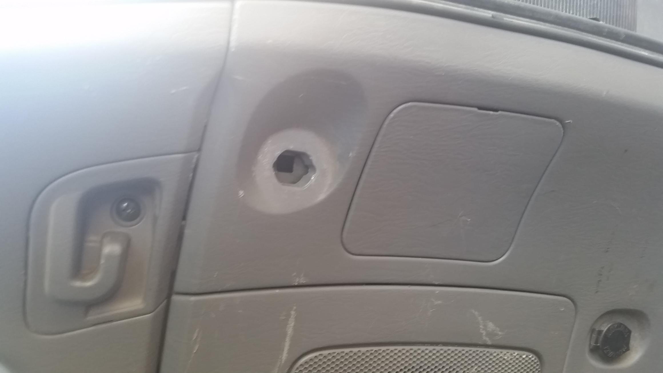

So after removing my rear quarterpanel a few times to get to the sub and amp two of the cargo net clips have come out and I can't get them to clip back in and stay there. I even broke one trying to get it in. Does anyone know where I can get new clips and how to get them in?

I went through the same thing. As you found out, you can't just jam them back in, you have to "unlock" the clips first. I forget exactly how I did it, but it involved pressing some tabs on the cargo net clip with a pointy object (knife or screwdriver) and then pulling it to unlock/retract the main tabs. Then it'll fit back into the hole and snap/lock back into place.

The metal behind the plastic panel is probably pushed in, making it impossible for it to clip in. You will need something like a flatblade screwdriver bent 90° to pull the metal back out.
