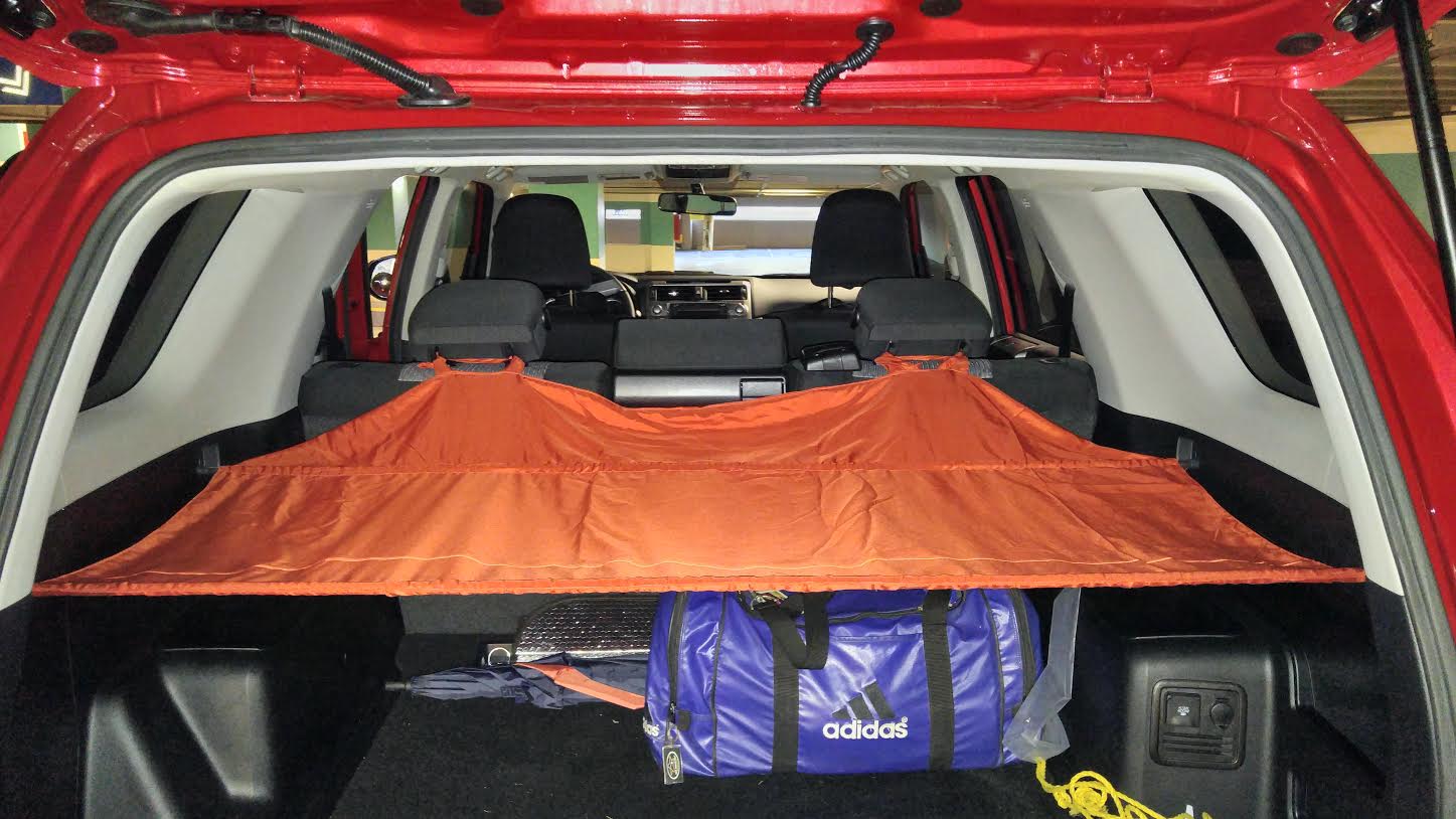

made my own cargo cover. Had some left over material so that's what I used. Bought 2 spring loaded curtain rods ($5ea) so I can easily remove. Not the nicest setup, but it was cheap and it does the job.
