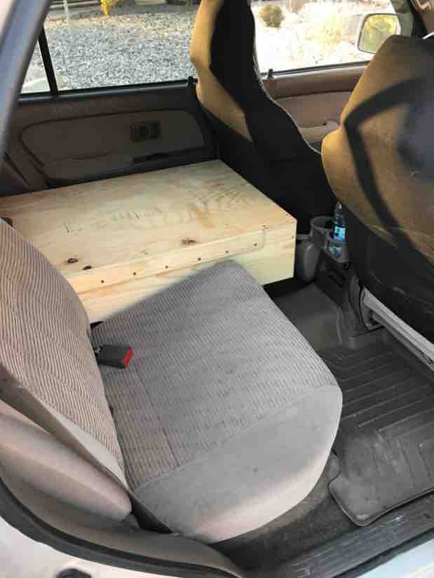

I’m 6’1 and manage “fine” with a short female and a larger dog. It’s all about replacing a seat with a flat surface and moving the front seats forward. You can place gear in the void between your bed and front seat to put a pillow on top of it. For reference; From back door to the front edge of my platform is ~73” and that driver seat is slid all the way back in pic. You can make a lot more room sliding the seat Forward.
Hopefully you’re going to be solo, or at least not try to squeeze a dog too. If you’ve got a +2 situation like mine, go get a sequoia or maybe one of those roof tent contraptions.
I’ve got to bring mtn bike/ski gear as well, so my space gets tight quick. Shuffling coolers outside and gear to front seats gets irritating, even with the storage under the bed and a big cargo box up top. My buddies sprinter starts looking like it’s worth the price tag.... until you drive it :D

Hi fellow tall person. I am 6'6" tall.
This is my first attempt:
Rickashay's Sleeping Platform
What I didn't like:
a) you have to load/unload all the cargo to flip the length extension open and closed
b) not enough headroom as IMO I built the storage system too tall.
What I did like:
a) sleeper for two
b) more cargo capacity in the drawers
A few vehicle builds later, this is my newest creation.
https://www.toyota-4runner.org/3rd-...shays-sleeping-platform-v2**.html#post3382694
What I don't like:
a) I wish I didnt have to pull the rear seat bottom to get this into sleep mode. But that was a trade-off I was willing to make in order to maximize legroom and headroom while in the sleeping space. It's nice to be able to sit up and get dressed with lower height.
What I do like:
a) versatility of switching between 3-person seat mode and single sleeper mode
b) lower height on sleeper side (as mentioned above)
c) max cargo capacity with removal of the one seat permanently (and I actually use that side cargo platform area for many other things when it's in daily mode)
d) items not used a lot are stowed fully out of the way but still relatively easy to access when required.
Since I am waiting in airport land tonight and this thread popped up, I'll repost a link to my semi-light sleeping platform.
My Low Profile Bed Platform
Since this original post I have put a few more holes in the under structure to reduce weight and pulled the rear seatbelts entirely out of the back space.
We have now used this setup for 3 1/2 trips totalling well over 24 months of sleeping in the back. Pretty happy with it. This could easily be stretched for the long shanked among us.
