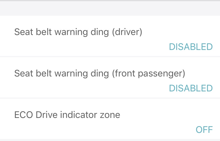

Carista Problem
Has anybody tried the Carista app and their dongle on a 2018 Off Road Premium?
I did for a few changes and it works OK for turning off the ECO bar on the dash. But when I set the options to turn off the driver and passenger seatbelt dings, nothing happens. They still ding when seatbelts are not buckled and ignition is turned on. I’ve tried several iterations of enable and disable and there is no change.
I’m in contact with the Carista developers and and they are “investigating” it, but it’s been a week and no resolution yet.
Has anybody else had experience with this feature?
Thanks.
I have a 2018 ORP and Carista works for me. When you toggle the setting, are you saving it first, or navigatinf back to the settings menu?
I do SAVE the setting after selecting it. The other options I’ve changed have taken hold and worked OK. Like puddle light on-time duration, locking doors when shifting into D, and turning Off the ECO bar. But the seat belt ding disable does not work. I’ve tried all combinations of driver/passenger/On/Off and nothing changes. I get 5 dings when the ignition key is turned On if the driver seat belt is unbuckled.
Were you successful in disabling the seatbelt dings?
This is my Carista screen after I make and save the changes. ECO change works OK but not seatbelt one.

I disabled the seat belt ding in a 2017 and 2018 Offroad Premium. Both worked the first time.
What obd2 dongle are you using? Phone? Can you borrow a friends obd2 dongle?
I’m using Carista’s OBD2 dongle and the iPhone Carista app.
But now that I think about it, are there two seatbelt ding functions that are independent?
One case is when you start the truck with your seatbelt unbuckled, and you get 5 dings. Then it goes silent.
The other case is when you put it into gear and drive off, and some time later get a reminder ding that seatbelts are unbuckled. I presume this is either speed, or time, or distance driven related. I also presume the reminder ding repeats after some interval if you remain unbuckled.
I always buckle my seatbelt eventually when driving, just not always at startup or while backup my out of a parking spot. So I’ve never gotten the drive-away dings (second case).
But I always get the 5 dings at startup (first case), even though the Carista app reports the rings are disabled. These are the dings that bug me and I hoped to get rid of. I’ve never tested it, but maybe Carista only disables the drive-away dings but not startup dings.
Can you confirm this on your rig?
Thanks.
Tested this morning. No seat belt, start vehicle I get a few dings. Seat belt on, then start vehicle, no dings. My work vehicle is same way.
With vehicle running, I can unlock the seat belt, get a warning light on dash, no audiible minder.
I just tested mine and got the same results.
So my Carista dongle/app works OK. But Carista just does not disable the 5 startup dings.
To confirm, the seat belt chime off is only after the 5 bell warning at initial start up. If you or the passenger removes their belt while driving there will only be a warning light on the dash, no chime.
