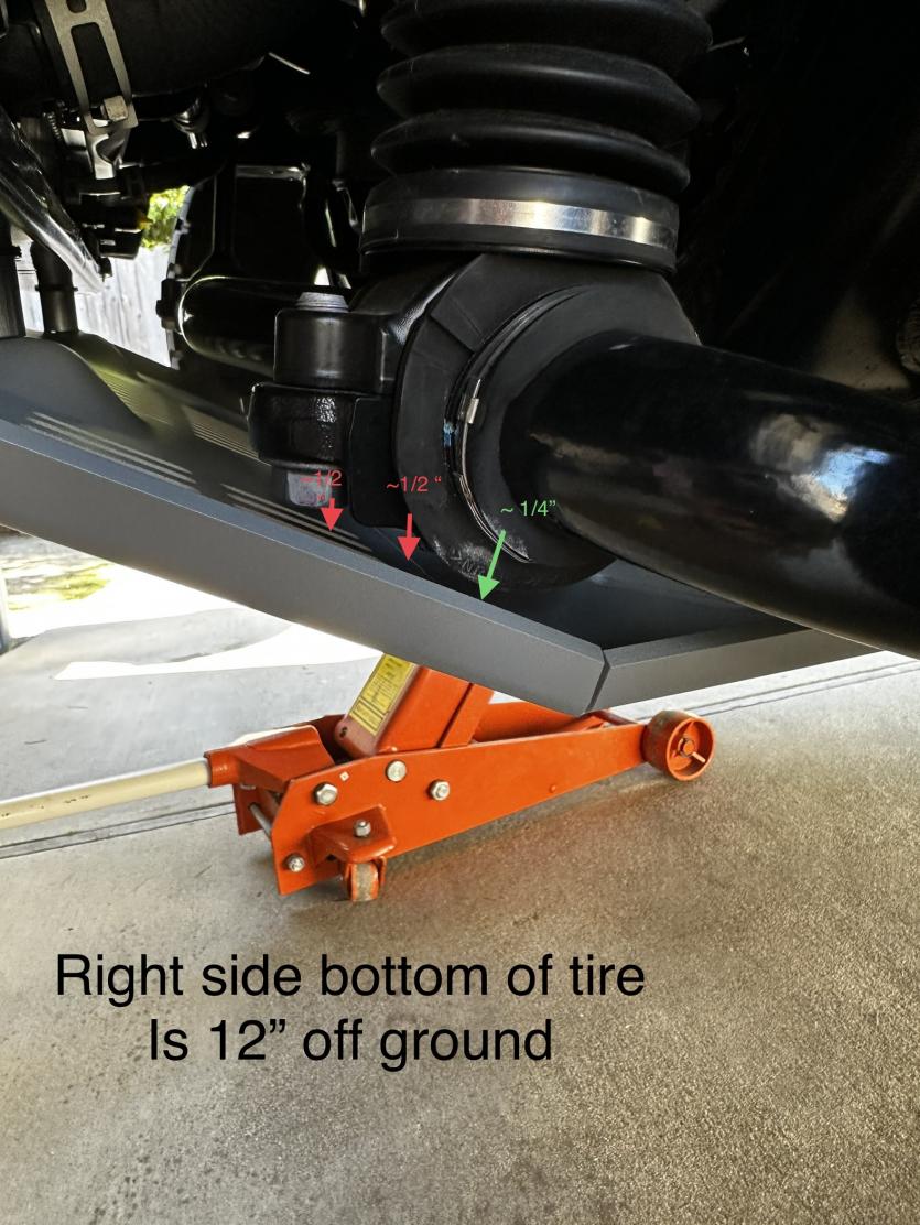

Good call on the discount code. I used it as well and added it to my post. Weird yours came with two sets of spacers as mine only had the one. Was yours the KDSS skid as well? The rear definitely does not need spacers. Everything lines up with the other skid. Some of the comments I read were that there wasn't enough clearance for the KDSS pistons with the spacers CTH gave installing the bolts in the way I did with the longer bolts and spacers in the front. However, I feel the spacers I did get are bigger than some of the others I saw in pics. Maybe CTH has since updated it since the earlier ones and are shipping with bigger front spacers.
I just want to add that you don’t need to remove the black splash plastic cover to install this. Your able to tuck black splash shield and use the longer bolts provided to put it back on. Makes it for a more Oem look.
Good call on that and good to know. I was going to go back and try to put that back on even if I had to trim it.

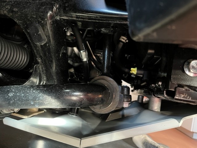

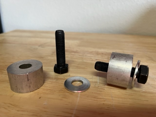

My CTH hardware package included two 1-1/2" spacers with nylon and regular washers and bolts which I used up front. Also included were two 3/4" spacers, washers and bolts which I did not use. The longer ones seem to be fine and give plenty of clearance for the KDSS. The CTH skid also integrated nicely with the new SSO slimline steel bumper and RCI integration skid plate.
Has anyone tried this full flex?

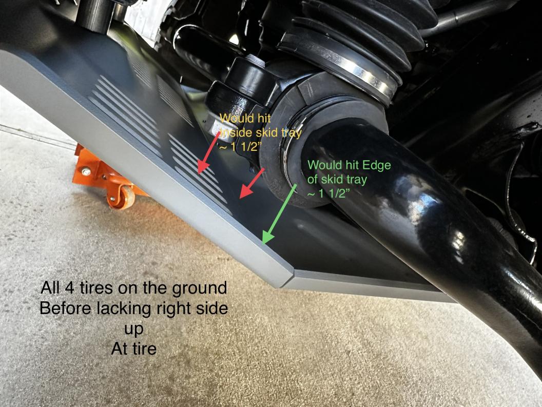

I just installed this on my ‘21 ORP and it went ok but a little concerned about clearance. Has anyone put it to the test on trails to see if it clears at full droop?
Thanks in advance!

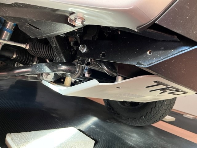

Finally got around to installing mine (KDSS) after sitting in my garage in the box for about a year. ;). The hardest part was offering up the plate long enough to get the front bolts started without a helper. Mine came with the spacers for the front but all four bolts were the same length, and the two for the rear are too long for the tapped bolt holes. I may either try to reuse the bolts for the frame support arms or it's off to the hardware store for some shorter replacements. I'll be checking regularly for any interference with the swaybar.
ok this skid was cheap enough for me to buy and try.
Mine came with 4 long bolts and 2 short bolts, and I'm glad it did.
If you are running a diff drop kit, you will need to use the 2 longer bolts and source some spacers for the rear mounting holes. This is no different than the OEM toyota TRD skid plates (requiring spacers for the rear) if you are running diff drop.

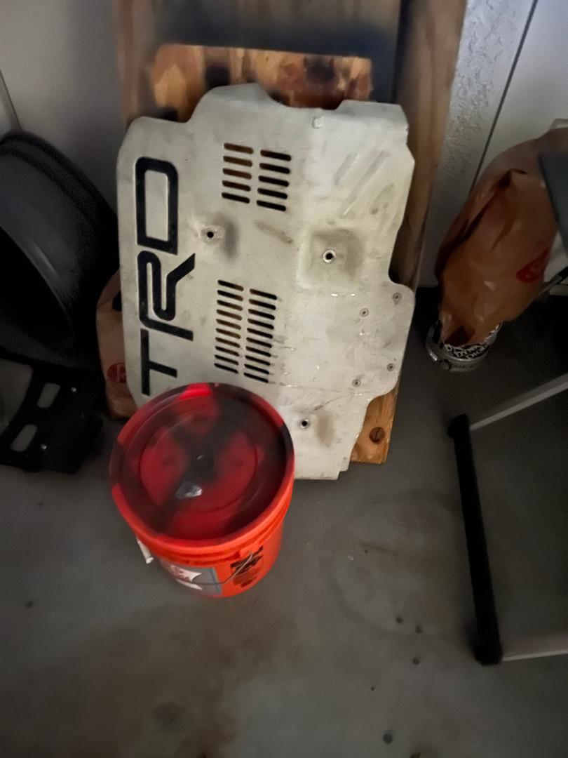

My OEM trd skidplate is feeling kind of sad now.
Might clean it up and turn it into a piece of art wall hanger.. :bolt:
