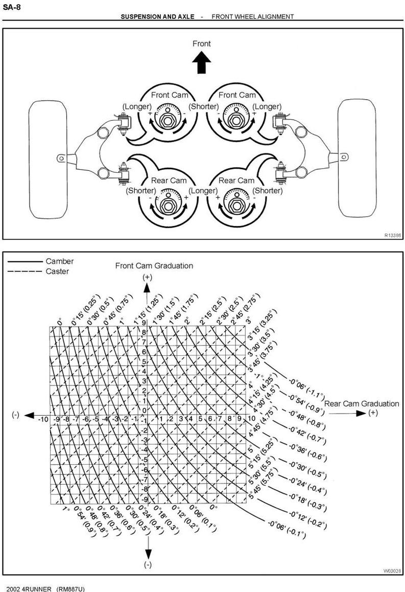

Upload a pic of the eccentrics (cam bolts) if you can. Your camber and caster are linked, and you will lose caster when you increase the ride height.
The way it works is the front cam is camber adjust. The rear cam is caster adjust. You want the tech to set the cam first and get that in spec, then max out the caster—so front cam should be forward as much as possible, set, then adjust the caster, and toe last.
See the below chart from a 3rd gen, it's the same concept.
