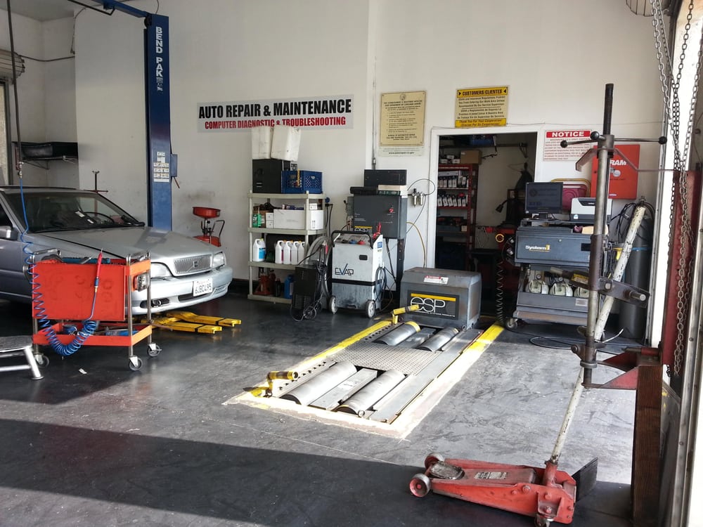

I forgot I had disconnected the battery to do a little MIG weld before I went to get smogged and realized it when it came up not ready. Went out driving three times, 77 miles total before it was ready. Shop owner who has a gen 3 said to cruise 45-55 mph for a while. We have the dyno type smog machine here in CA where it puts the rear wheels on a conveyer belt type thing and simulated driving it while a probe is in the tailpipe. I think pre 1999 cars must do this.
