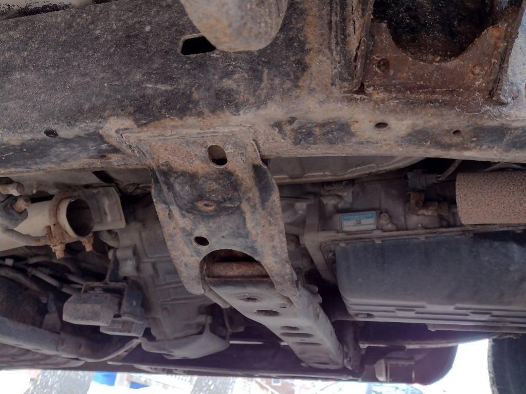

Someone decided to steal my catalytic converter.
Trying to save some money.
They also took the flanges with it as well.
Has anyone used a Walker 93303 cat?
Or any other universal cat?
The Walker is 13" long x 7.5" wide x 4.5" high.
Or if someone has straight piped how much louder is it?
I know that will give me a CEL but will it also affect performance of fuel mileage?
thanks
I have no experience with that Walker cat but a quick search came up as an Ultra EPA cat almost $550 CAD - ouch. Since the flanges are gone any you need more work than just a direct fit cat why not look into something like a Magnaflow 94005 - $170 CAD, It's Stainless, Stock size 2.25" in/out, slip fit so it can slide over at least 1 connection, then you just need some pipe and a flange. Not sure about the emission rating on it though. Do they even have emissions testing in Manitoba?

I never thought of Magnaflow, thanks!
I see Amazon has them so I could send it back if I can't get it to work.
If I got that one I might try and use adapters and clamps with it.
I can get the Walker from Rockauto for 285 CDN delivered and it has 2.5" ID.
No emission testing in Manitoba.

I think I'll get my local garage to weld in a straight pipe. They won't charge much.
I don't have much room between the end of the cut pipe and the O2 sensors.
It will be difficult for me to use clamps and get a reliable seal.
After the straight pipe is installed I can cut part of it out to install the cat.
The pipe they put in will be the same diameter on both ends making the cat install easier if I get one with the same size inlet/outlet.
If time is a big issue like you say then I would agree in just doing a pipe for now and address it properly when you have more time. As long as you still have a muffler it shouldn't be horrendous, if any major difference at all.
