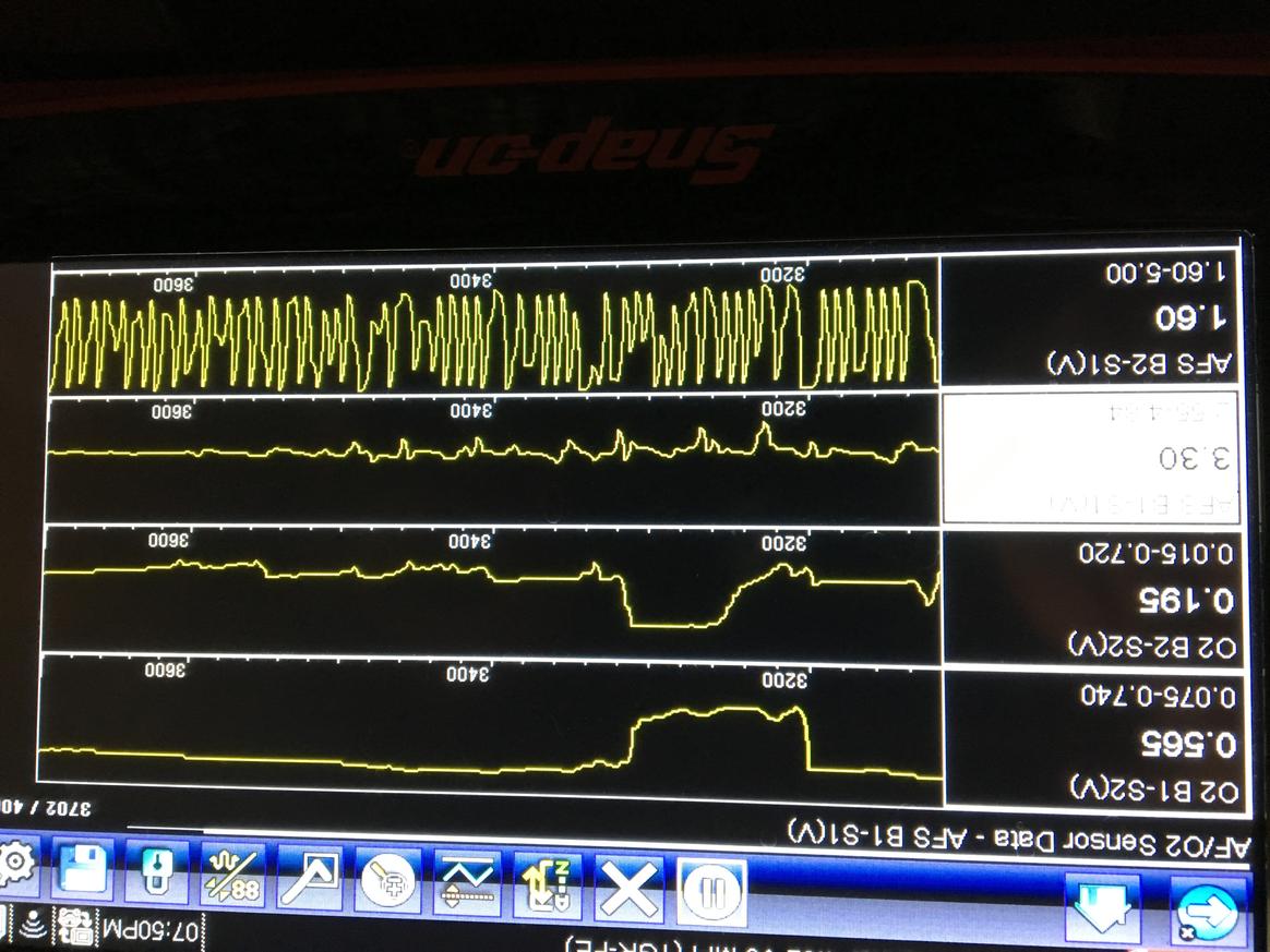

Upstream and Downstream 02 Sensor voltages
Background: Back in May I replaced my bank 2 sensor 1 with a $46 upstream sensor from Rockauto. In July (2K miles later) I did my emissions test but failed because my cat conver eff. and 02 sensor both read "Not Ready". I can't imagine I didn't put it through the correct drive cycles.
Is anyone familiar with the correct voltages on a 2003 Toyota 4Runner's upstream and downstream air flow/02 sensors? Is something off in the attached image? Bank 2 sensor 1 was replaced and it seems to be much more active than bank 1 sensor 1.
(sorry picture is upside down...i am really good with computers)
