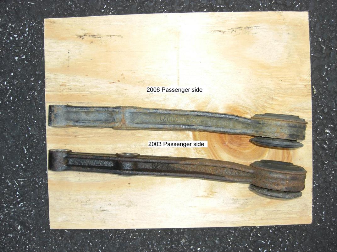

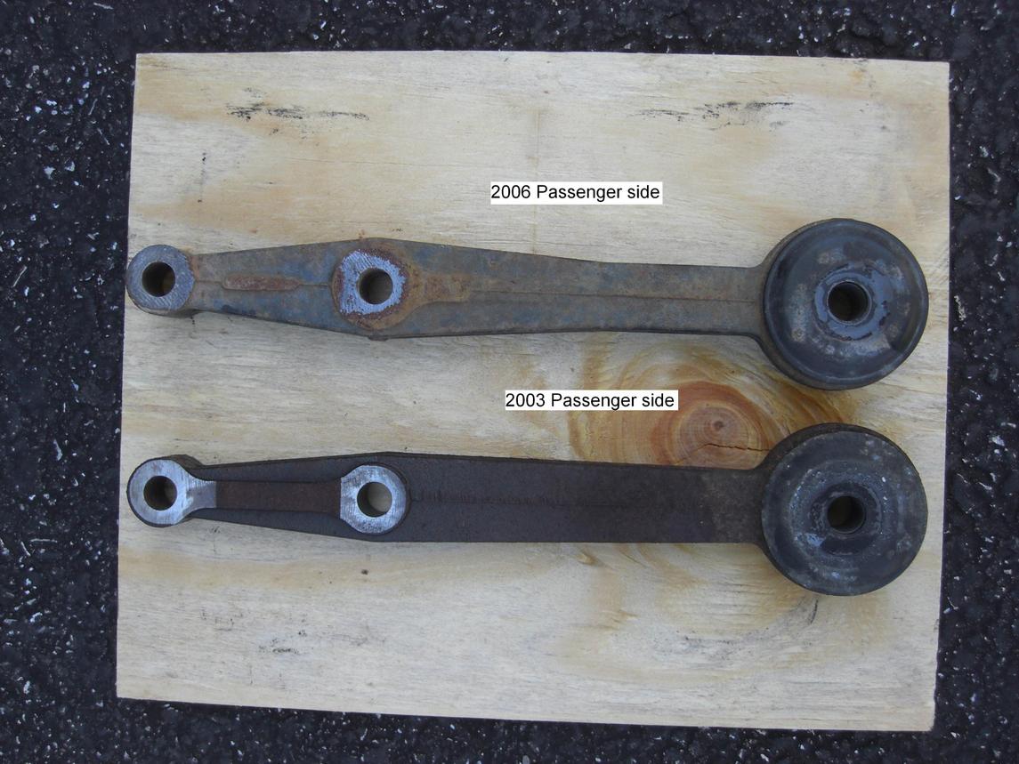

Fluke in that I had full RCI steel skids and it deformed the skid enough to kiss and cause the bracket to break. 06+ for sure should all have the redesigned bracket, and it sounds like late '05 models.
No, it wasn't me... but I do have the beefier bracket now.
I wonder if its a result of the RCI skid design? Im not 100% but I believe the person I saw with this issue also had RCI. You have the gusseted bracket now or just the newer one with the stamp?
That crossed my mind, but I don't have the data or tools to test it.
Just the stamped one, so slightly beefier vs 03-05
