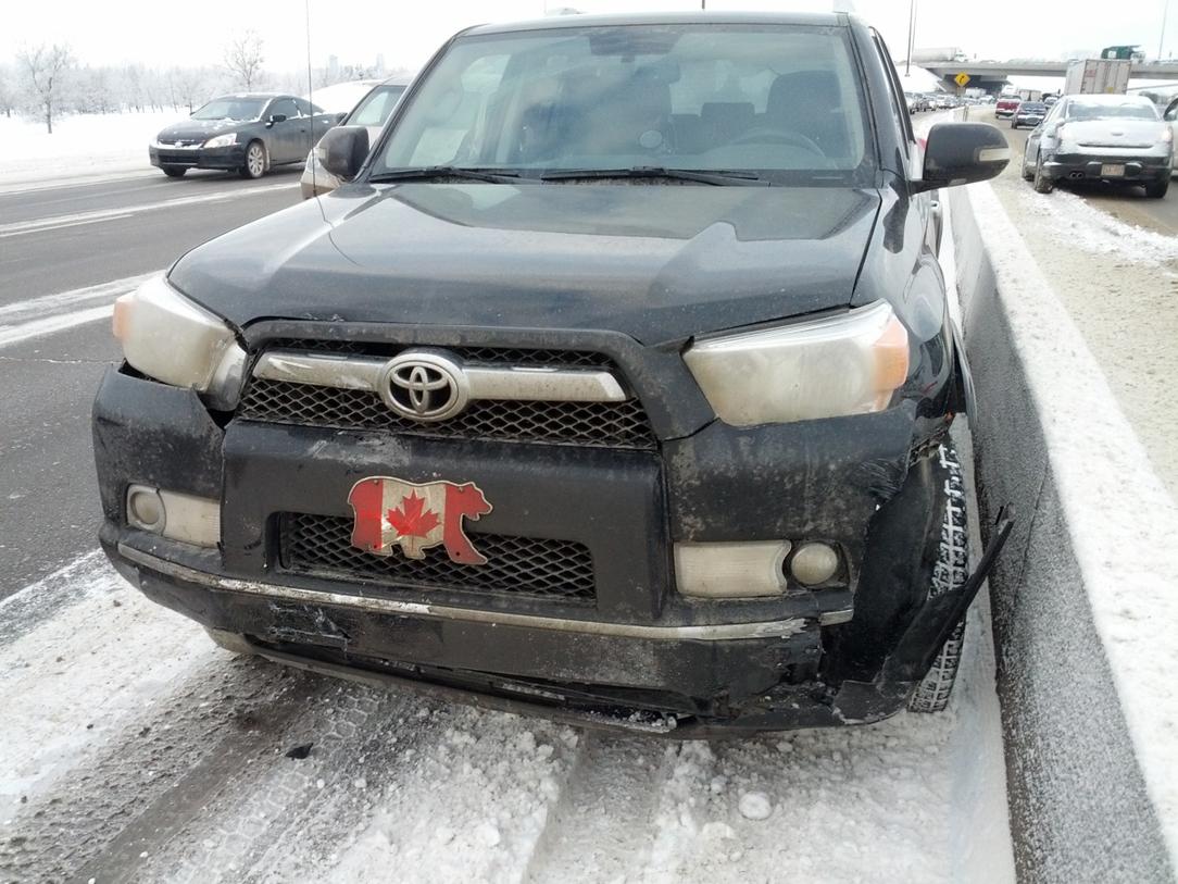

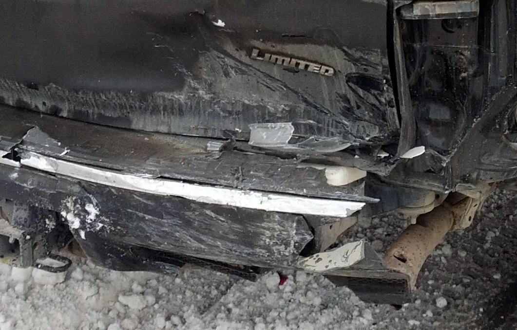

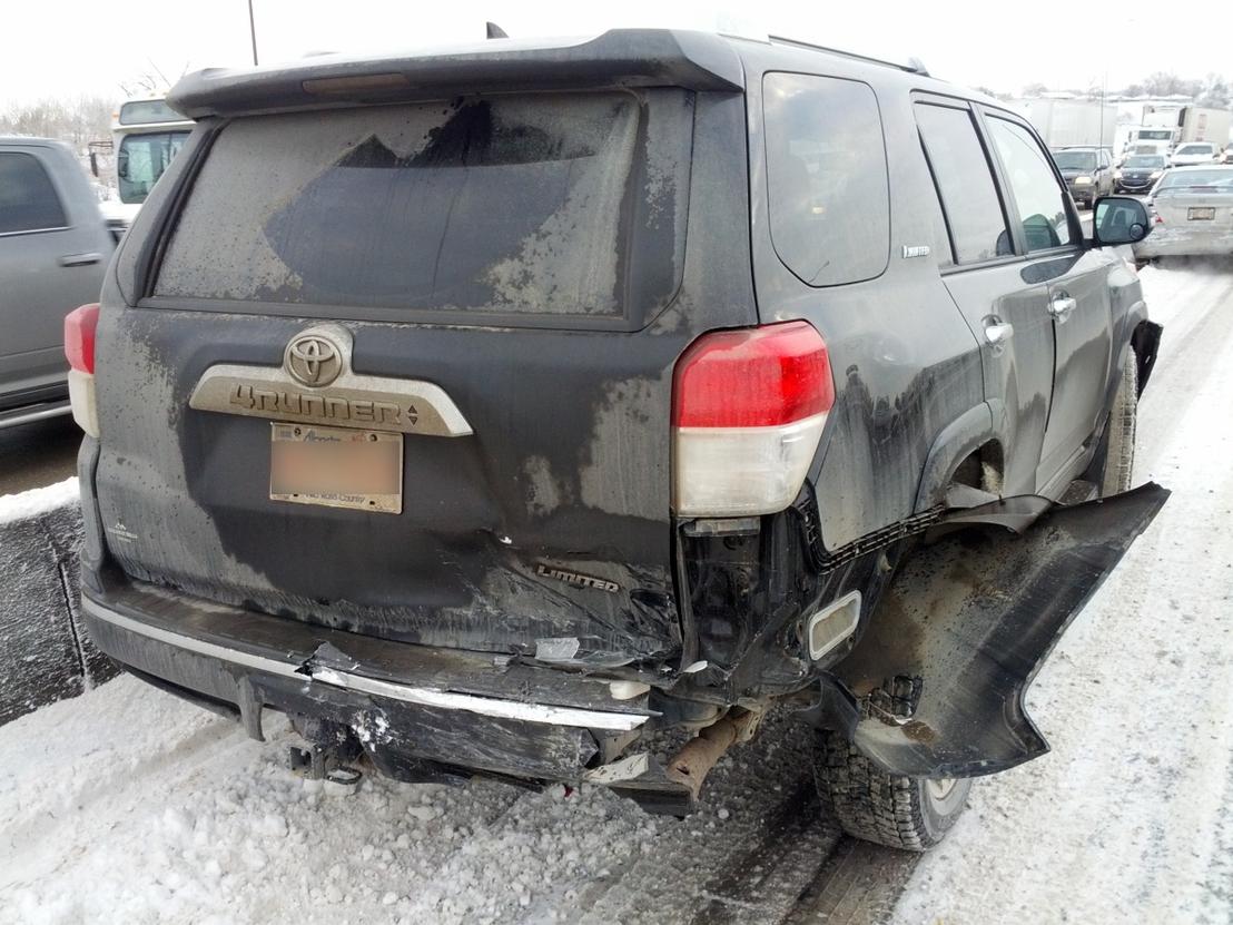

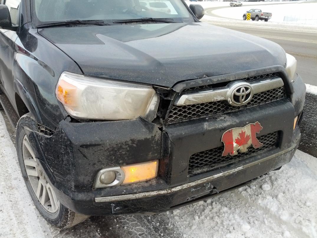

I was caught in a multi-vehicle collision a few days ago on my way to work. A Honda Civic two lanes away from me was hit by a semi and slid into my lane, hit the barrier and stopped. I couldn't avoid it:redbrick: and got rear-ended by a Honda Odyssey. The collision was on 100km/h city highway, luckily, no one was physically hurt.
My 2011 4Runner was hit pretty badly, especially in the back. The tail gate still opens and locks, but was pushed in. Half of the rear bumper was gone, and strangely, the exhaust pipe got a 2cm size hole on top of it's end. I confirmed with the police officer that I had ZERO fault, so next thing is to deal with the adjuster.
Talked to an adjuster yesterday, and she asked me to get the 4Runner to some generic all-brand body shops on her list(I had my 4Runner towed to my dealership's collision centre), and said may use some after market parts. This makes absolutely NO sense to me:rant:. I'm the owner and I don't need the insurance company to decide how to fix it. I may also lose the warranty if it's fixed by some random body shops.
Anyways, do you guys have any suggestions on how to deal with the adjuster and anything I should pay attention when getting the 4Runner repaired?

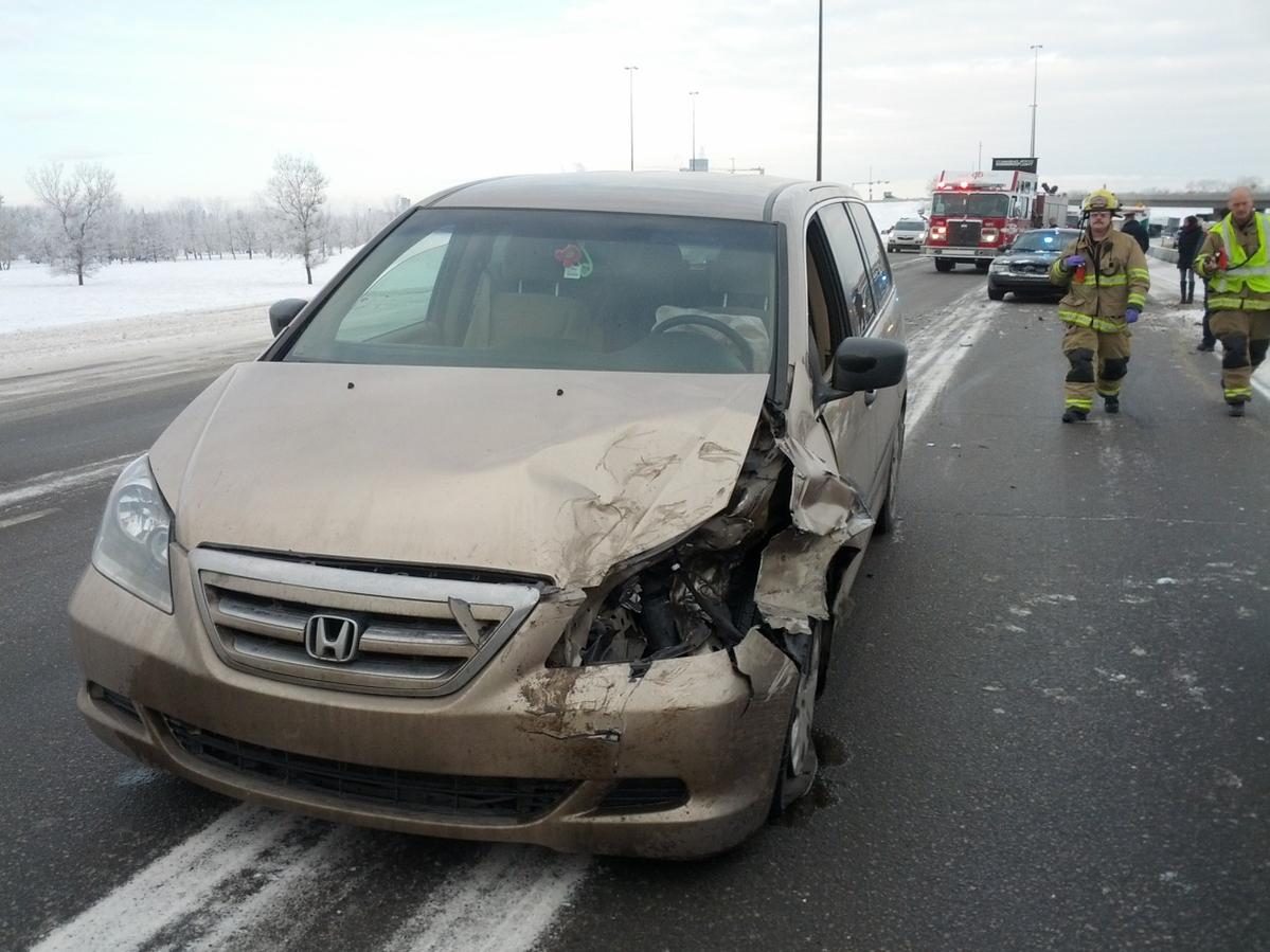

The Odyssey hit me. Air bag fired off.

As far as things to look out for I would make sure the frame isn't tweaked, have them confirm all suspension components are in the correct spec and do that bumper to bumper. Also when it is all said and done pay very close attention to new rattles, ride quality etc for your first few hundred miles. Anything doesn't seem right take it back.

Second have the shop check the frame very well. Based on the angle you were hit, you could very well have some frame damage. If the shop feels it can be fixed move on to the next step, if the shop doesn't... totaled.

BTW, the hole in your tailpipe- looks like the exhaust was pushed up into the rear bodymount bolt during the collision causing the hole. That was quite an impact! Make sure they inspect the entire exhaust system for bends or cracks.

At a minimum you're looking at on the rear:
1. Rear lift gate and potentially the surrounding structure it mates to
a. Any damage to the trim pieces on the inside of the gate?
b. Any damage to the sill plate inside?
c. Rear liftgate speaker?
2. Rear bumper and underlying bumper support
3. Right rear frame area may be tweaked/bent
4. New exhaust tailpipe. Looks like it was bent up into the rear body mount. This could translate into more damage upstream in the exhaust...cracks bends, tweaks etc. Also may be damage/tweak to the body mount
5. Looks like the rear hitch took the brunt of some damage. It may be tweaked.
6. Metal structure under rear taillight is damaged
7. Taillight clear section appears to be cracked or is it just the lighting?
At a minimum you're looking at on the front:
1. Left front fender
2. Front bumper plastic
3. Grille
4. Lower spoiler area
5. Left front fog light housing
6. Hard to tell in the pic but the left front headlight could have scratches etc.
7. Hood lip looks like it has slight damage. Probably cheaper to replace than try to fix.
8. How's the AC condenser in the front?
9. Radiator core support could be and probably is tweaked.
10. Front end alignment needed.

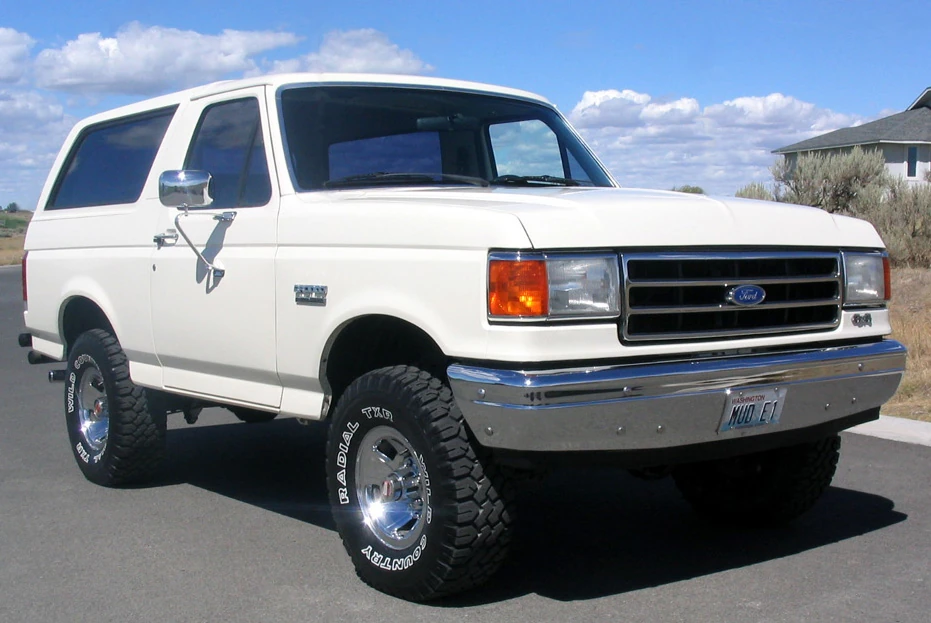

Glad everyone was fine...but this is why I miss vehicles like my 90' Bronco with REAL bumpers that extend the full width of the vehicle!
*Not my old one, just a grab from the net.
