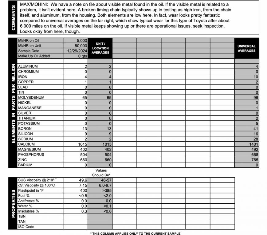

Well looks like some good news from Blackstone anyway. All readings are below average. That with the inspection I did with endoscope is really pointing me towards over all OK inside TC at least. I'll be doing another oil change soon to see what shows up and will check with magnet and see what's on the drain plug.
I'm pretty certain I've got the annoying whining idler gear issue and that my accy belt pulley's are starting to go bad. Double checking that and will replace if they need it. The TC idler gear is just a bummer but seems like many have this and have 150-300k miles on the engine. Shame to do the work to crack the front cover to replace a $20 part and possibly have the issue return in 40k.
Feeling a little better. Gotta say seeing the metal flake in oil and hearing some interesting sounds really had me stressing for a bit. I'm hoping all is well. Truck has really good maintenance records and low miles so would be sad to think there's a major issue.
