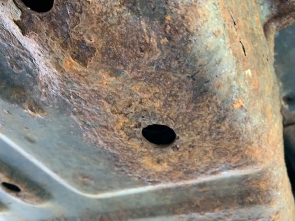

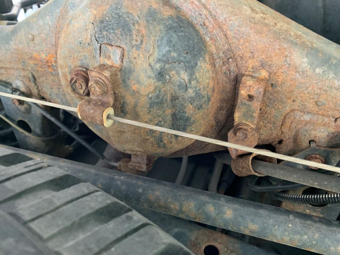

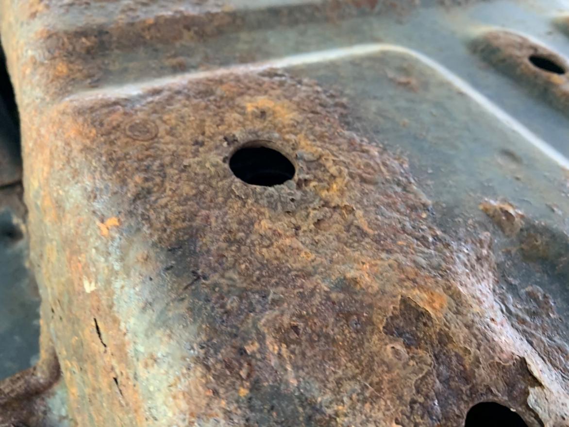

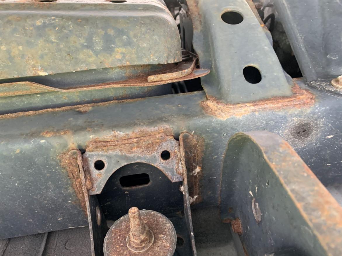

Cause for concern? See pics
I'd probably be interested in it for $2500 to $3k, the rear axle is kind of alarming but otherwise it's not too bad compared to what I see around here. I'd give the known problem areas of the frame a good smack with a hammer first
This doesn't look good.
The other stuff wasnt all that bad (but I would still walk probably) but this pick is for sure a forget about it.
I'm in AZ and had my dad ship me his old jeep from jersey. It was a rust bucket but I took on the challenge and think I did a pretty good job and stopping the rust.
But with no emotional attachment to a vehicle it just isnt worth it. Keep looking for a nicer one. In your area rust is hard not to be on at least some of the vehicle but at least look for minimal and pay some extra money if you have too.
I have ZERO rust on my 97 but plan on traveling a bit with it. I need to figure out a way to protect it.
BTW I think that one dripping spot is from rust converter. Works pretty good too.
I also agree that $4200 is a lot for what we see in the photos.
I paid $2500 for this in Nov 2018 - Needed a bumper fender headlight/corner. Limited Auto, but with a locker. Since it lived in NM and CO all it's life, zero frame rust.
My '97 5-speed also has zero.
Don't pay $4200 (although I get wanting a 5-speed - I also looked for months.)
Just curious what area of the country this rig is in. As I agree with the others the back plate probably has a pin hole and that frame had to be in salt water to only have the back half rusted like that. If in rust belt the entire frame would be rusted.

Sad to see you pass up on a 5 speed! Price was a little high but not outrageous. The 5 speed owners are very stubborn and they over price their rigs from what i've seen in my local area. The honest truth is that this runner wasnt really that bad from what I saw.. a used rear axle housing from a junk yard is 75 or 100 bucks tops in my area. If there was no hole in the frame right next to the muffler on the inside, by no means is it too far gone. You will grow to love this rig like I did mine and over the course of the entire summer if you dedicate 40 hours under your rig to a complete de-rust project like I did your truck will look brand new underneath like mine does now. If you're not a DIY guy then dont get the truck. If you are then dont pass up on it. Were talking a lot more elbow grease than anything here.... Once again before I get attacked by the mob for what i'm saying, provided there are no holes. Just cause a lot of people say something is too far gone or because they wouldnt put the time into restoring it doesnt mean you cant do it. The other thing I will say is its basic economics. Go on auto traders and do a nationwide search for 3rd gen 4runners. You will find 10 manuals and 15000 automatics. Why do you think the price is high? Supply and demand. Cant look at 20 year old trucks and not expect to have a shit ton of work to do to get it in great condition.
EDIT: I think more people on these forums need to tell people why they should buy a rig and not a million reasons why you should stay away from one. A guy like Jackstraw was smart and passionate enough to find this community and instead of guiding him towards fixing up a rig and preserving the 3rd gen community we've convinced him to pass on the 3rd gen. Next thing ya know someone else buys that truck and never even looks underneath untill shes rotted out in a junkyard somewhere 5 years from now. If it gets fixed this year she wont have that fate. Thats why this site is dying lmfao.
I appreciate the feedback. One concern that someone pointed out was the hole behind one of the wheel, driver's side rear I think. Completely rotted through, near the brakes.
I am about a 50% DIY guy I would say. I won't be replacing the timing belt myself but I fully expect to get underneath and scrub away what rust I can and coat everything. I can do body things myself as well like replace the grill or fenders. My gut is telling me this is still worse than the pics let on.
I emailed again to ask about the inside of the frame and got no response. Probably tired of me being an educated buyer.
So - if I end up with an automatic - strawberry milkshake is what I am hearing. If the radiator is "yellowed" then it would be good to replace. If it looks black and clean, its good or recently replaced. Anything else to this story?

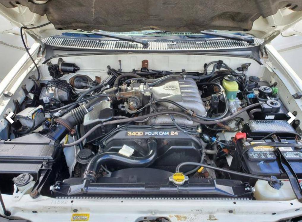

Rusty engine bay brackets hint at rust problems underneath again. Cross your fingers that the frame is good!
Engine is non-interference, so even if the belt breaks it isn't a big deal.

$4500 truck. That rusted panard bar mount may need attention latter down the road. You may need to get the timing belt and lower ball joints (at a minimum) done since you can't confirm when it was last done.
Are you sure you want this truck? Do you have the extra funds and comfortable with doing your own wrenching to bring this rig back up to base line?
If not, I would walk and look else where for another 3.4l 5sp rig. True, they are hard to find but, they are out there. Just saving you from getting burnt out trying to baseline the truck, when you can wait for one that is in better shape and needed less work.
I surely won't be replacing the axle myself, thats for sure.
In that case I would avoid it and look for a cleaner vehicle that has been well maintained, even if the axle doesn't end up needing replaced a lot of other little things that might crop up can end up with you dumping more money into it than it's worth.

That frame doesn't look too bad. The rear dif is questionable because you don't know how much metal might flake off once you start to do any rust mediation. The underbody on my truck looks better even being in NJ but it was undercoated at sometime in it's life before me (and it spent a portion of it's life in the Southeast part of the country) and I've been pretty meticulous with rust mediation after my 1st 4Runner which was a complete rust bucket (before I knew any better)
The problem with getting pictures of the INSIDE of the frame is you need some sort of borescope. There are cheap ones that actually work great. I bought one so when I sell my truck, I can provide those pictures which will be soon (I hope) if the frikkin DMV would ever open up again.
