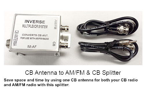

You would need one of these
I looked at mounting a CB antenna where the stock AM/FM antenna goes when I first bought my 4R. I found a good number of warnings and examples of the stock location splitting from the extra weight/ wind force. I decided to just go with a ditch light mount to mount it to.
Then I used the above mentioned splitter to plug into it so my CB and AM/FM use the same antenna. It works great and with a quick disconnect comes off easily for when I go through a car wash.
