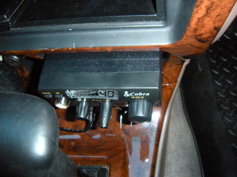

Im trying to install my cobra 19 cb radio where the ashtray usually is. I havent plugged in the antenna wire yet, but it still sticks out way too far and i cant get it to go in any further. Do i need to move all the wires behind it to get it to go in further? its as far in as i can put it right now and the antenna isnt even attatched. does anyone know what i should do about this?

Yes i'll try and move all the wirings out of the way. There are bundles of them that could be blocking the CB from being inserted farther in.
Also if you haven't already done so, get a 90* UHF adapter for the antenna wire at the back of the CB.
lol gonna have to cut out the back of the ash tray and take the metal thing the ashtray slides into out
Yeah, not sure if you've done it yet, but you need to dremel out the back panel of the ashtray area, and unbolt the top metal slider.
yea i already cut off the back of the ashtray. im gonna try to move the wires and see if that helps. do you think i definitely need to get the 90 degree uhf adapter, or do you think i could maybe make it work without it, without the cb sticking out too far?
Seeing as how the CB radio currently sits, I would suggest getting the 90 degree adapter. It will definitely give you more room to push your radio in without any chance of kinking the antenna cable...It's cheap too.
I've got the same unit and mine sits virtually flush on top of the plastic trim.

you can get the 90 degree elbow at Radio Shack. If you are wanting a smaller antenna, try the older cell phone booster type antenna that the coax attaches to the back window and you have the actual antenna that is on the outside. Definitely no long range but should be fine for trail groups.
