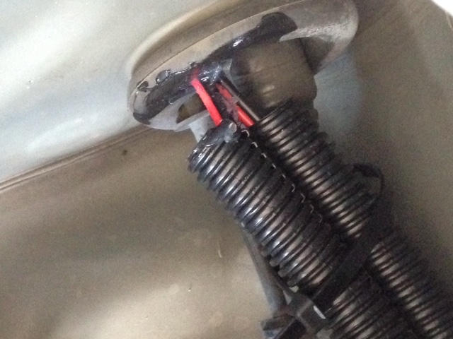

I got a PM asking about some of the details about installing these. Below is pretty much exactly what I responded with. I thought I would add that here in case it helps anyone.
The whole install took maybe 15 minutes. It's really easy, so don't worry too much:). The cowling is a pretty soft plastic/rubber, so cutting it was very easy while it was still attached. once you have the fender pulled back you will see for yourself, there is plenty of room to work with. Just make sure you use something sharp and go SLOW so you don't cut too much or make a wrong cut, because then you may end up with a hack job or buying yourself a new cowling which defeats the purpose of not taking it off! A utility knife, or even a good steak knife should be good enough. Realigning everything was easy too. My truck was a little dirty, so seeing the lines on where the fender was when I unbolted it was simple enough to line it back up. If you are a little off you probably wont even notice it. These have a lot of room for error when putting it back together. It just depends on how pretty you want it to be ;).
There should be three bolts on the top of the fender (I think, refer to the CBI instructions for clarification or just pop your hood), and one when you open your door hidden in the jam there. Like this. Just keep the doors open until you are done with the entire install.

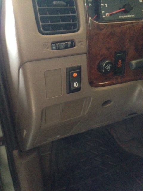

One other thing for folks who buy these... if you get the switch that CBI sells with them, it will NOT fit the standard punchouts in the 3rd gen 4Runner. It is too tall and a hair wide. Frustrating... so now I have to either dremel it bigger, or find a new switch.
Good review. Thanks for sharing. I too have the CBI ditch brackets ready for install. Good to know that one can trim less than suggested by CBI. I will keep that in mind. I got the wiring harness too but do not like the switches that they included. So I bought 2 OEM switches from Savage Off Road. OEM fitment FTW!

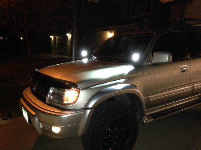

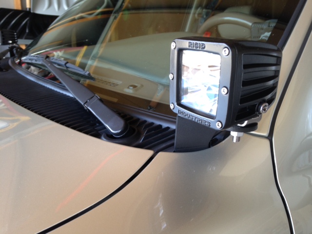

Here are a few pics of my install. Notice that I decided to skip the Rigid switch, and also the switch through CBI that was too large. Instead, I went with a Toyota OEM switch which is a perfect fit and matches the dash pretty well. I would highly recommend this switch. Enjoy....

I used that same switch for my light bar install. I like that it is an OEM part and looks like it too.
