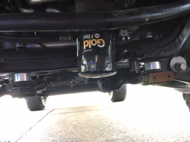

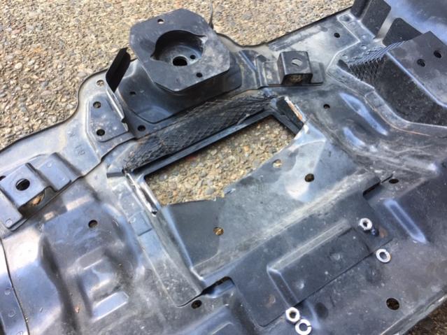

Also I had installed the Baxter Performance oil filter adapter a couple weeks ago so I could use a regular spin on oil filter.

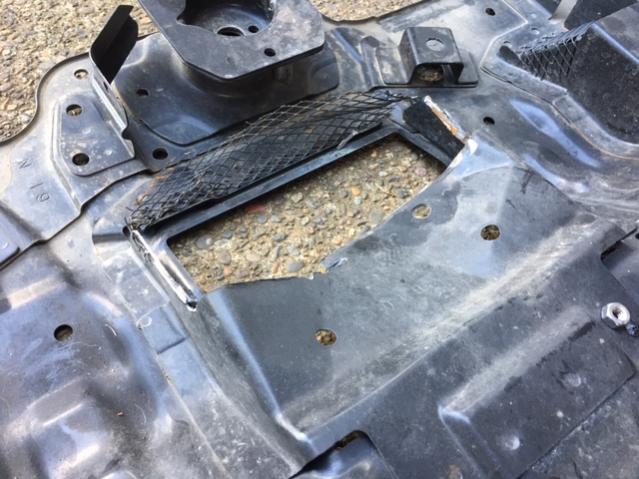

I had to modify the factory skid to clear the filter I used because of the piece sticking up on factory skid I had to hammer that a bit and cut some out.
With the CBI skids it cleared great with 2 inches to spare so that was another plus and seems easy enough to replace filter without removing the skids now.

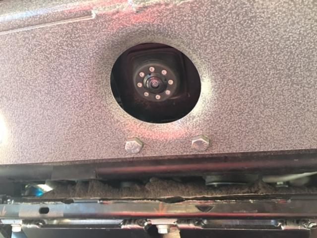

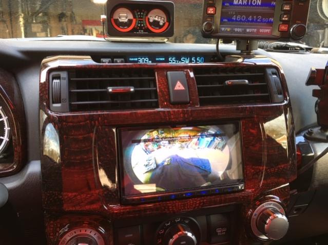

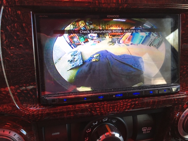

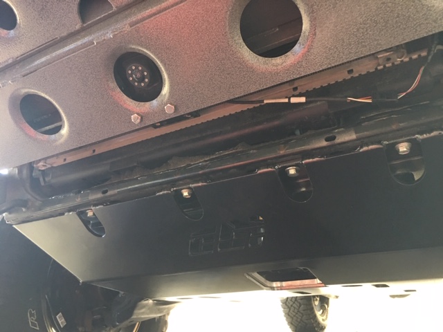

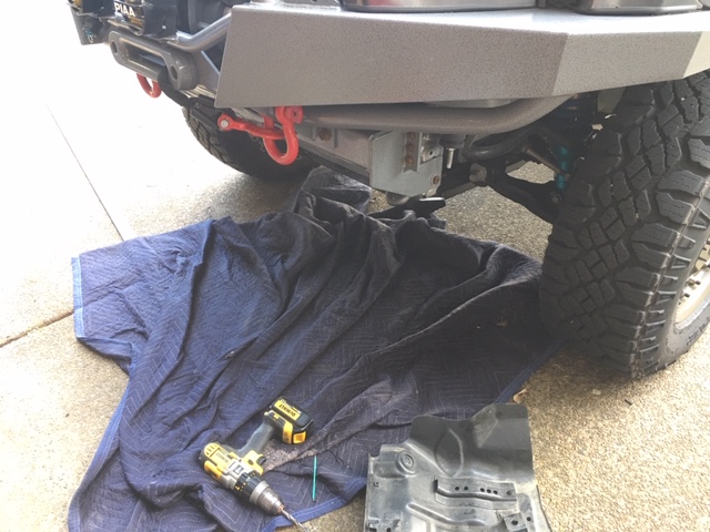

I had also temporarily mounted my rock camera on the factory skid before so after installing the CBI skids I finally got around to installing the rock camera up in a hole in bottom of bumper which protects the camera better anyway.
the pic of the work blanket under front of vehicle then seeing the front view on the screen gives you an idea how super wide of view this camera is lol
And you can see I painted the front skid with the matching toyota touch up paint, I know its gonna get scratched up but figured better blending in a bit than standing out

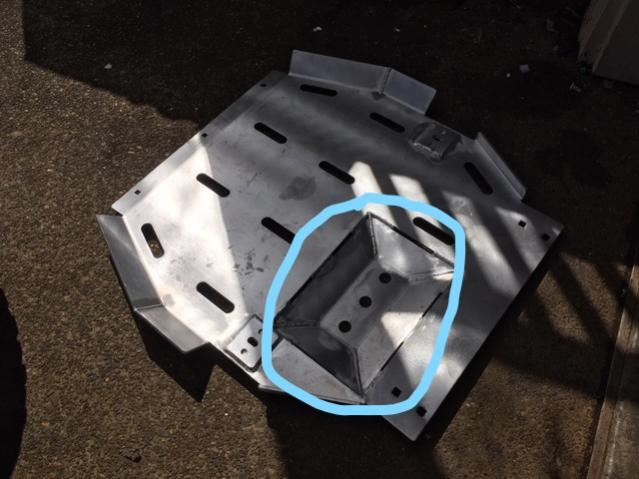

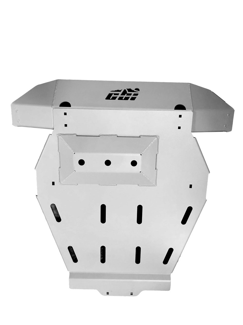

One thing I don't understand with how these skids are made is what the purpose of this square area that sticks down from the skid. It is nowhere near sitting under the transfer case. There doesnt seem to be anything around that area once mounted so I don't get why its there?
Hopefully someone at CBI can elaborate on that?

Here is a better view of that area installed, I dont see anything anywhere near it? But now that you say that maybe that was where the stock Y-pipe ran? I don't remember now lol

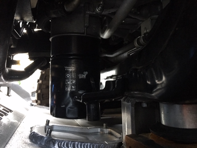

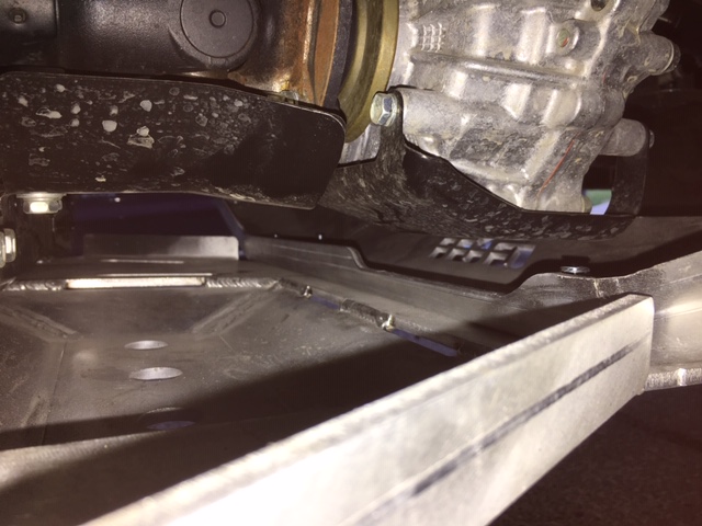

here is a better view of the clearance for my oil filter now with the CBI skids. I could maybe even get a longer filter for more filtration since I have lots of clearance.

Just saw this old post. That's to accommodate the stock exhaust crossover.

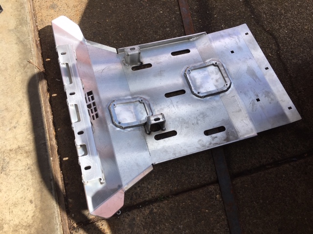

ok Aluminum skids just arrived 10 minutes ago. got them unbolted from pallette and used a digital bathroom scale to weigh each piece.
Front Skid= 26.8 pounds
rear skid= 24.4 pounds
rear crossmember and all hardware still wrapped on it= 10.8 pounds
total weight= 62 pounds
