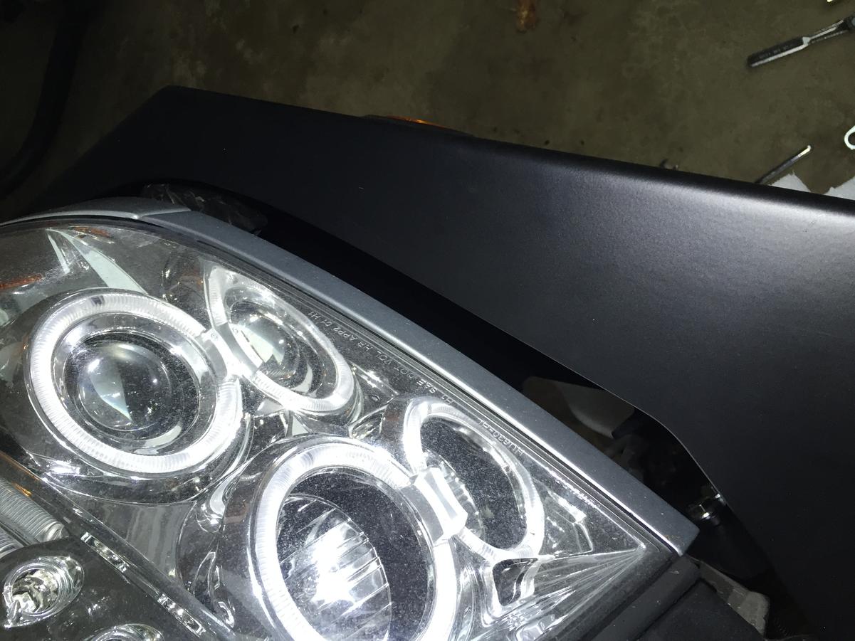

I'm in the middle of installing my bumper and I just don't know if this looks right?? There is about 1" to 1.5" gap in front of the headlights. Is this how it's suppose to look? It looks like it should just slide straight back.

Looks fine. That's the gap you ignore. Looking from the front, you want it to be centered, level the tilt, and at least a 1/2" gap between the bumper ends and your fenders to accommodate frame flex. I wondered about the space you're concerned about too, but it's the one that isn't a variable. You won't notice it. That's just how they are.
