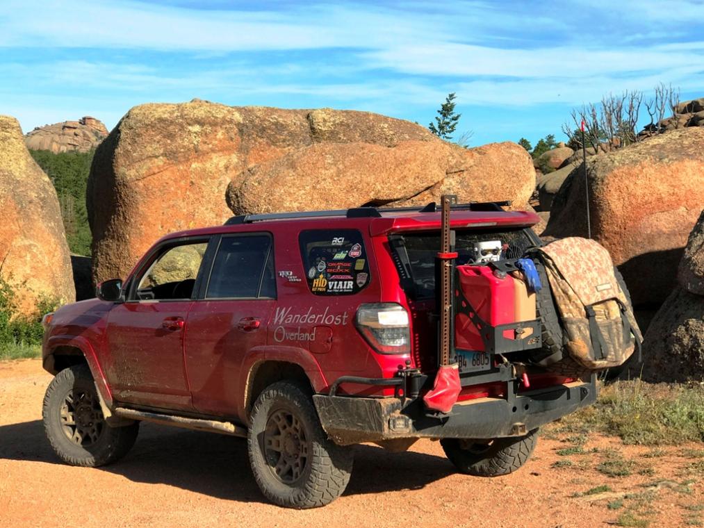

We have the CBI rear dual swing-out bumper and find it one of our most useful mods. However, just going by the information you spelled out, it doesn't sound like you need one.
The #1 reason we went with one was the larger tires we run. The spare would hang down too low when stored underneath and we needed that space for an air tank. It sounds like you're not increasing your tire size so that won't be an issue. #2 for us was the ability to conveniently carry cans of fuel and water, plus a propane bottle. Depending on what fashion of "overlanding" you plan on doing you may not necessarily need that feature either.
The CBI bumpers are engineered extremely well and fabricated even better. They have the most stout swing-out hinge on the market. The camera is rendered useless in its stock location because of the spare tire however, there are aftermarket wire harnesses that relocate the camera to the swing-out itself. Not the easiest job of running the wires but the wires themselves are plug-n-play. The bumper is heavy and moves weight more rearward, will definitely create a sag with the stock suspension.
