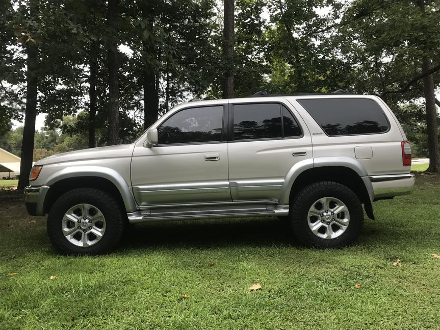

Took a few pics today with the good camera:
Now I am just waiting on parts to arrive to do some actual work!
