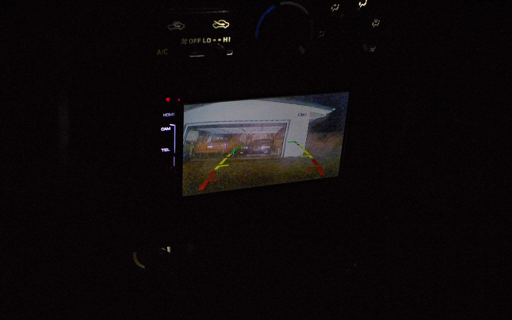

I'm getting married this Saturday and have the week off so yesterday when my fiance was running around with her family I tackled the backup camera install.
The install is pretty easy; if you know how to wire a stereo you can definitely tackle this.
I ended up mounting it in the license plate frame which did require drilling a hole behind the license plate. I drilled out an old frame I had in the garage but plan on making something nicer and Toyota related.
Ran the wires through the tailgate and through the factory harness.
I couldn't get the wires through the rubber harness no matter what I tried so ended up running it separate. Not perfect but good enough.
It works! Not really necessary as it's pretty easy to park anyway but kinda cool for how cheap and easy it is.

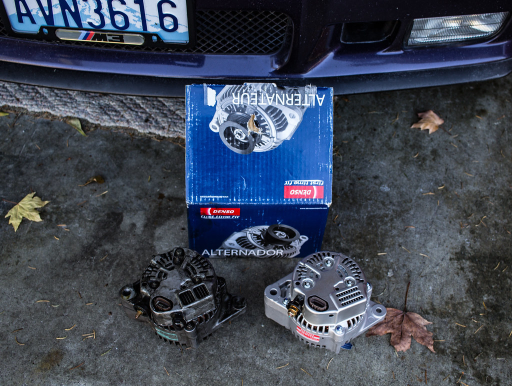

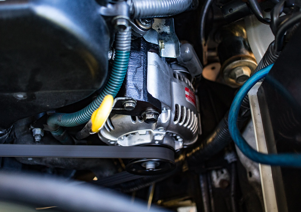

So the alternator took a dump last Thursday as I was leaving for the airport to pick up my mom and grandma for the wedding...Great. It happened in a super busy intersection too so a cop had to push me a ways to get me off the street.

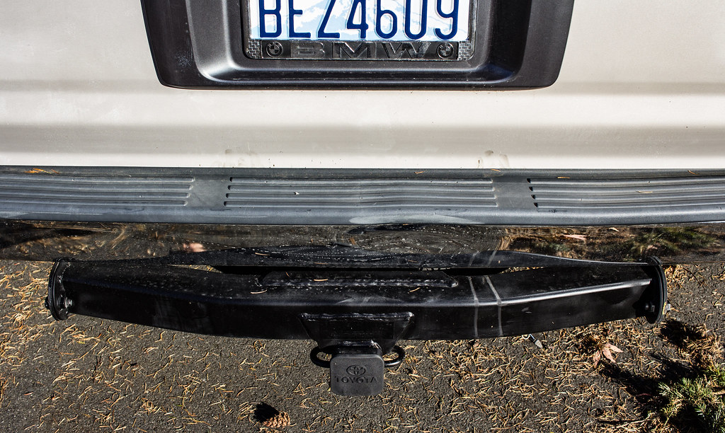

So, the rear bumper that I already replaced once is now dented. At least it matches the front bumper.
Ordered a remanufactured Denso unit off Amazon so I could get it here quick.
Buttoned up and running like a champ!

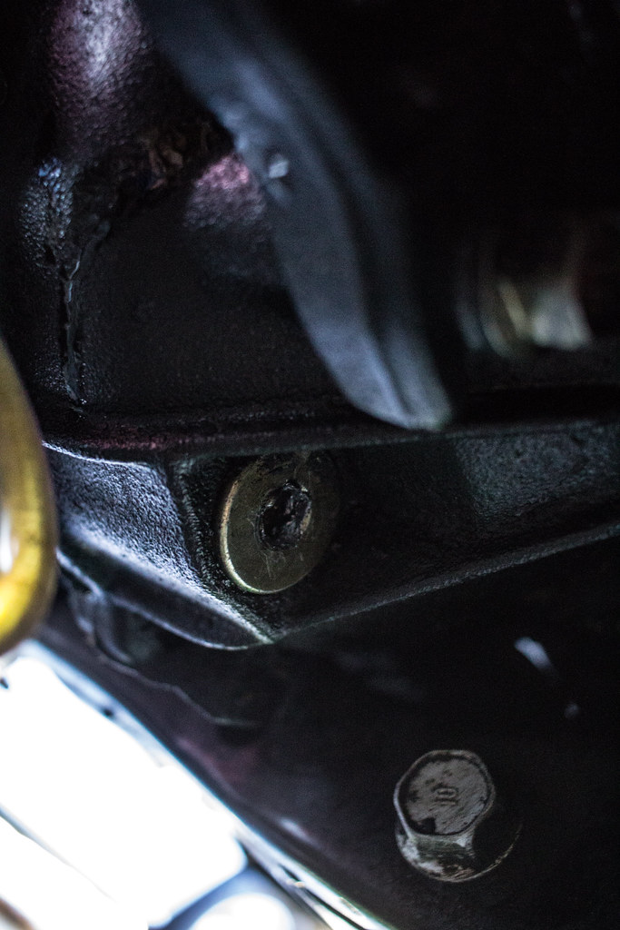

Last Friday I changed the front diff fluid and ended up stripping the drain plug :redbrick:
I was able to break the fill plug loose so ended up vacuuming as much fluid out as I could and refilled with Redline 75w90.
Stripped plug, will save this battle for another day.
The fluid I sucked out actually looked really clean so I'm guessing at least it must have been changed somewhat recently before I bought the truck.
Since this is the worst thing that has happened with all of the work I've done this year I'm not too upset but still kind of frustrating.

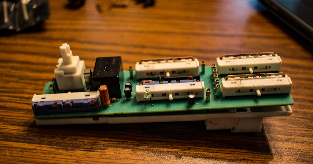

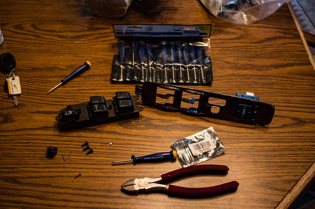

I took apart the the window switches and the ECT switches to swap LED's into them. Neither of these take a plug in bulb, the LED has to be soldered to the board on both.
Window switches taken apart:
Old bulb that needs to be cut off:
Here is the LED soldered into place; not the prettiest job but it works:
You can see them both lit up bright on the left side:
I just need to figure out the defrost switch and hazard switch to finish the whole conversion. I bought the wrong bulbs for those(they look right?) and took out the brake light fuse last night. Whoops. I ordered a few different LED's today so I'll post what the correct bulb is once I figure it out.

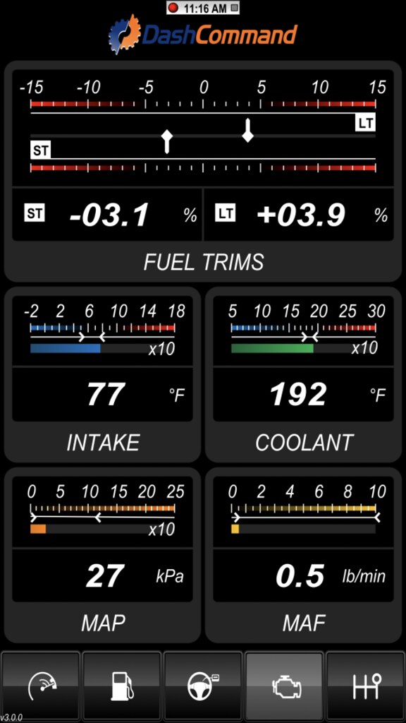

One last thing, I was curious what my coolant temps have been after overhauling the cooling system when I did the timing belt. Bought a cheap OBDII reader and am happy to report I haven't seen them go any higher than 192 :thumb3:

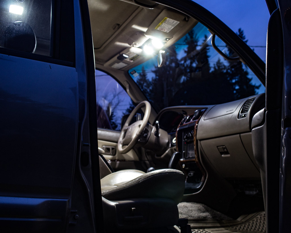

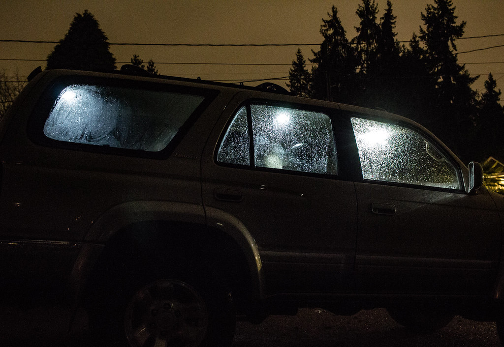

I messed around with the 4Runner today and installed LED's in the two dome lights and map lights. It is BRIGHT with them all lit up.

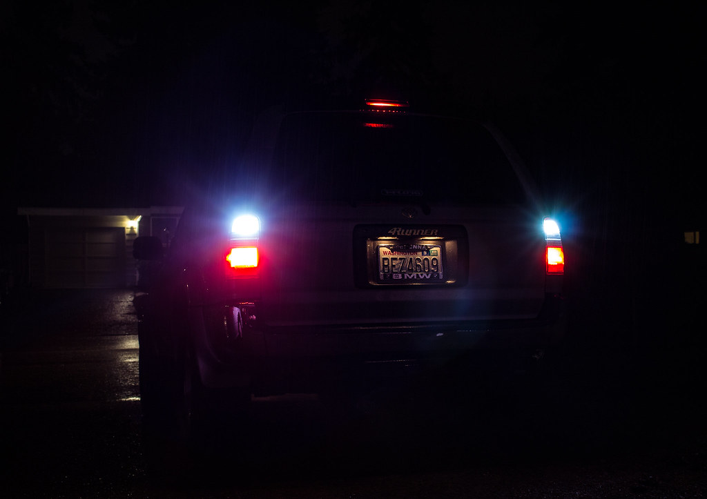

I also put LED's in the reverse lights to see the reverse camera better at night.
These are also very bright!
Much better.

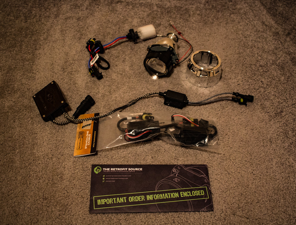

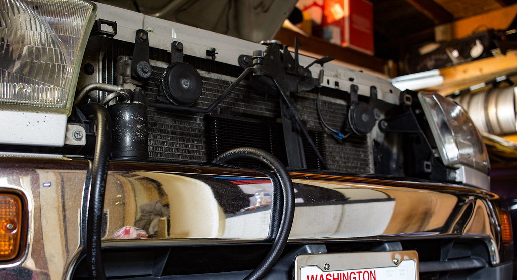

Finally bought some car parts that aren't strictly maintenance related so it's getting there! Got a retrofit kit from The Retrofit Source. I have some time off over Christmas so will be getting this done as well as finally doing the transmission service and transmission cooler.

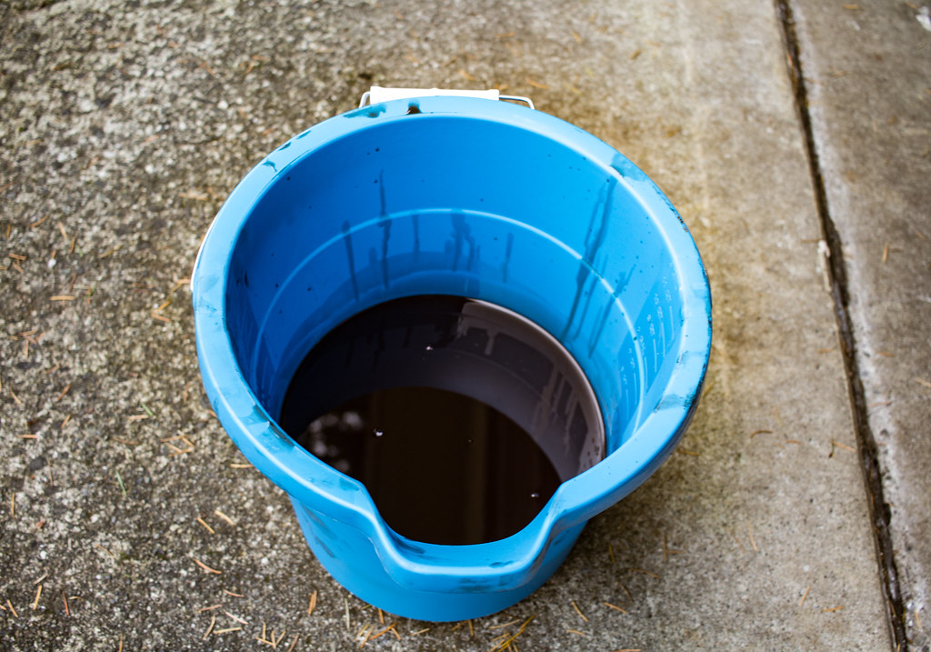

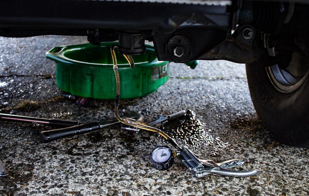

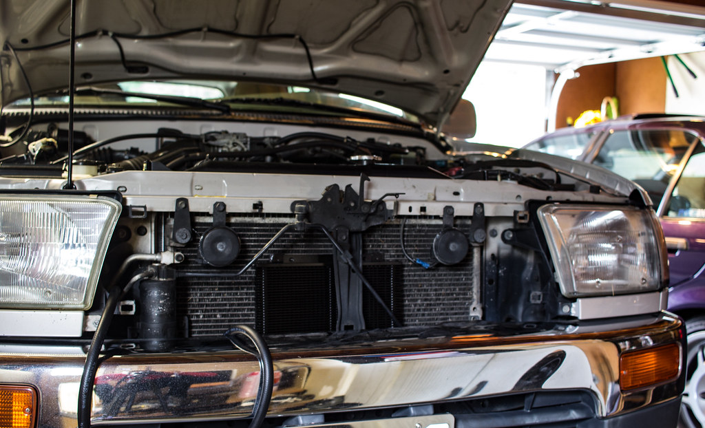

I installed the transmission cooler and changed the transmission fluid yesterday. I used the supplied pushpins to install it rather than the brackets, mostly due to laziness but it is definitely secure and not going anywhere.
I took out a total of 10 quarts of fluid, flushing a quart at a time and then refilling after each discharge. The fluid was pretty dark, overdue to be changed for sure.
Got a little over three quarts from the transmission drain plug.
Here is where I mounted it. I installed after the radiator cooler so it is in series after the radiator, I wasn't comfortable bypassing it.
And a current pic, I love this thing!
