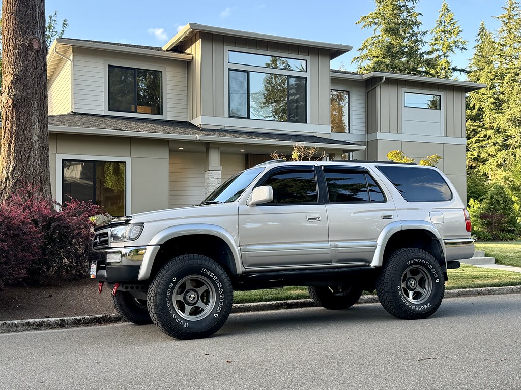

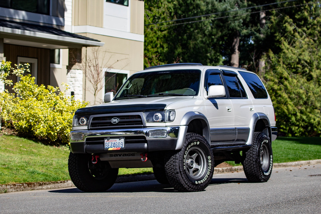

It's been a while since I've updated this thread. In June I started dailying the 4runner again and made a few changes to make it more streetable.
Maintenance/updates include:
-New valve covers and gaskets
-All new drive belts
-Brake fluid flush
-Sonoran Steel upgraded rear body mounts
-New 285/75/16 Destination AXT tires (if anyone obsesses about tire specs like me, these are the lightest I could find in a 285 at 51lbs)
-New black and clear front lights
-2002 facelifted tail lights
-Limited emblems axed
-New silver painted grill to replace OEM chrome
-Paint corrected and ceramic coated
The new tires have been great, much better on pavement than the mud terrains and I've seen an increase of 3 MPG!

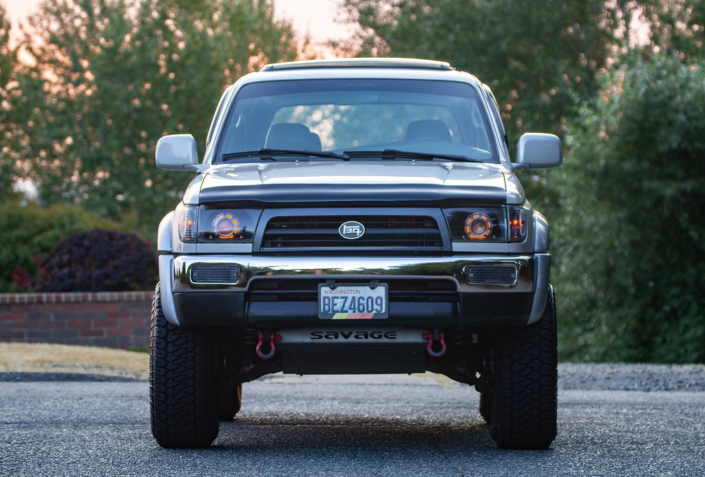

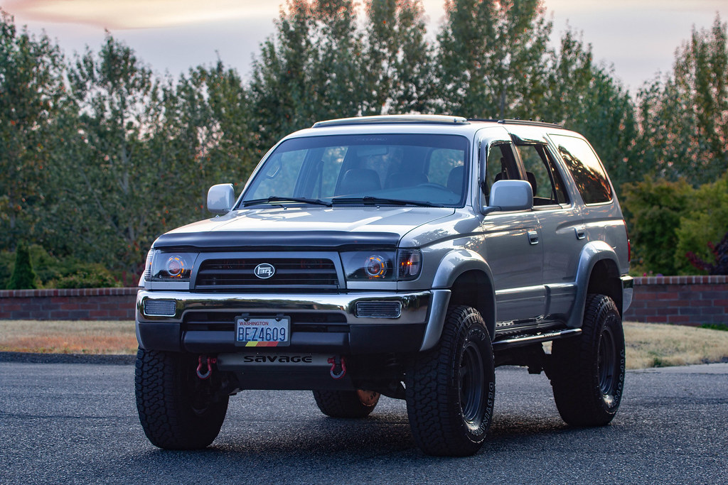

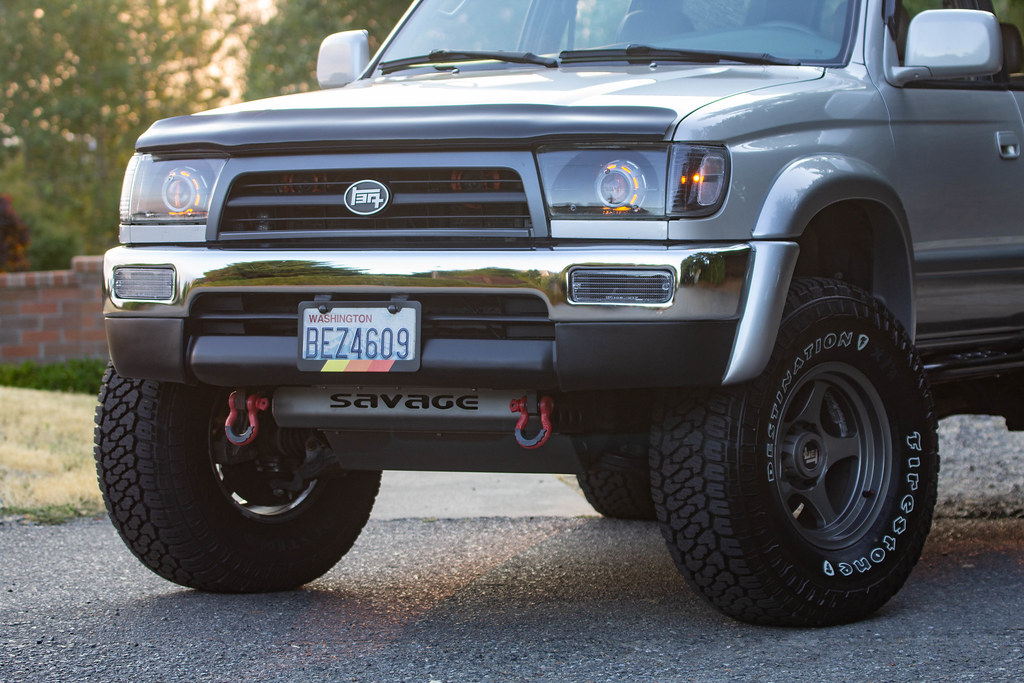

A few updated pictures for the thread:
Don't mind the bumper alignment. I gave up on perfect after the body lift lol. One day a steel bumper will fix it.
I swapped out my rear LC80 coils and Tokico shocks for Bilstein 5500's and OME 890's and a 1.5 inch spacer.
I was hoping for a softer ride in the rear as I usually don't carry much weight in the back. So far I'm pretty happy. As a side note, I developed a squeak in the rear which turned out to be the top of one of the shocks. Squeak is totally gone now.:whoo:

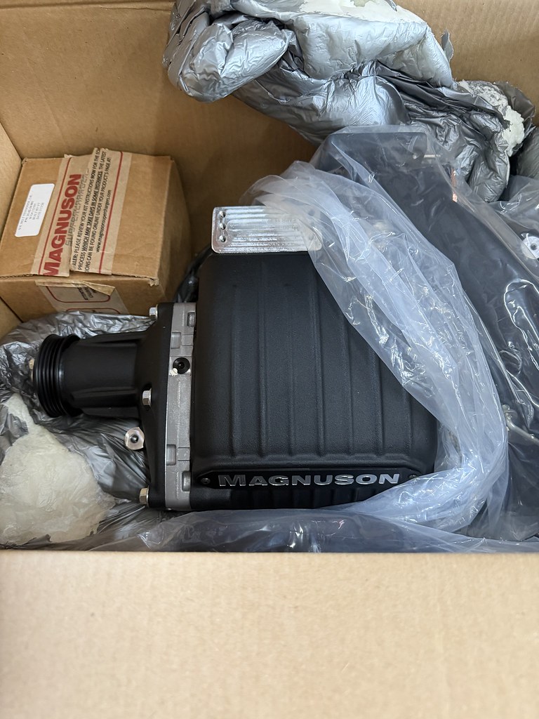

I picked up one of these right before the price increase this summer:
I've been tempted to throw it in, but I'm waiting for URD to release their updated 7th injector kit.
Also bought new injectors from MWP, along with new oem knock sensors and knock sensor harness.
It'll 'work' with stock pulley and an upgraded fuel pump to keep up with the extra flow/pressure needed. Agreed that a fuel and timing solution should be used long term through...
-Charlie
My original plan was to just run it and add the 7th injector later, but the more I've read on the newer TVS 1320, it sounds like it's even more prone to causing lean issues than the 1st and 2nd gen blowers.
I figured I've gone 12 years NA, a few more months (hopefully) won't hurt. I'm sure I'll do the 70mm pulley at the same time as well.
